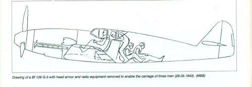

Wow, four men in a 109 ?! Remarkable ! Any mention about the mission of such a
modification ? Just removing the armour plate and the radio probably wouldn't have
been sufficient, as those men too easily would have fouled the control rods and cables
then. And "boarding/unboarding" would have been a task for trained gymnasts only !
If you have a look at an original 109, you'll know, what I mean !
But many thanks for posting this !
modification ?
I think the "mission" if you want to call it that was the rapid evacuation of fields being overrun - I seem to recall reading of incidents using both the Bf-109 and Fw-190 where ground crew or even other pilots were flown to safety like this rather then be left behind.

With the armour plate and radio needed to be removed first, a good early warning may have been needed.
But another point coming to my mind, when looking at this drawing, is the shift of CG. Don't think, that
armour and radio would have equalled the weight of three men ! So probably this proposal was never tested.
You would be surprised how fast people can remove such things when they need to. Also, when faced with the prospect of capture or escape such things as ease of flight (from CG imbalance or similar) hardly come to mind. This most certainly wouldn't be a thing anyone bothered to test - consider the environment it was conducted in.
As I mentioned above, I do recall accounts of this sort of evacuation being done a number of times using both Bf109s and FW190s - I will try to find the sources.

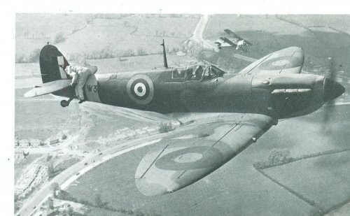

Ok, I agree ! The well known incident with the Spitfire mechanic "forgotten" on the tail, shows,
that CG problems were solvable. It was a much higher leverage ratio, then in the Bf 109,
overall weight would have still been ok, and yes, in the face of immediate danger, things can
be done really fast !

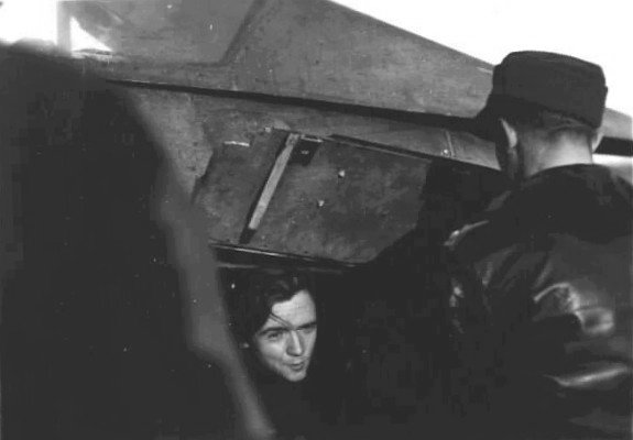

Caption: "Emerging from the cramped confines of the radio compartment of FW 190 F-8 W.Nr 585 584 'White 9 + -' at Kitzingen, 8 May 1945"
See here for story: http://fw190.hobbyvista.com/kitzingen.htm
