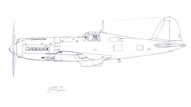

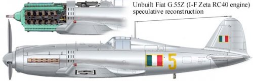

here a sketch about a possible Fiat G55 Z, with an Isotta Fraschini Z RC 40 engine. As a reference I made a puzzle with different drawings from Ali d'Italia , changing only some details.

Good work, but as this is an hypothetical reconstruction, probably it must be posted in the theoretical and hypothetical section. What do members think ?
interesting drawing,
Are you sure was speculative ?

About how is speculative the G55Z ? I don't know. I read about this version/project only some days ago, while searching materials for the FIAT G-61 and it was reported on a project list on italian magazine Aerei ( June 1976 ):
Is it speculative less or more than a Re 2004 ? Same engine, anyway the RE 2004 had an order for two prototypes and there were pictures of the SM 79 engine installation studies, while about the G55Z I think we have only list of the version reporterd on magazine and no contracts, drawings from FIAT and so on ... that may be make the G55 more speculative ...
Anyway I like the shape a G55Z could have ...

Very nice Giovanni. One comment though. The I-F Zeta was an air-cooled engine so no radiator bath required ;)

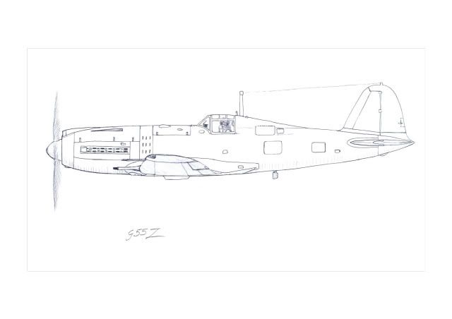

I change the profile in this way, manteining an air scoop under the wing, just because The Caproni F6Z had under the nose an air scoop, so the engine tested on SM 79. Was that air scoop for the overheating problem of the engine ? Or for what ?
So even the RE 2004 profile needs to be changed ... no radiator bath ...

Good call Giovanni. I suspect that this under-nose scoop on the F.6MZ and SM.79 testbed was for an oil cooler.

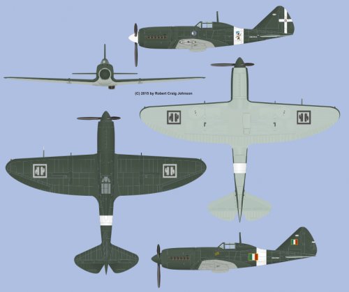

The duct under the Re2005 housed the oil cooler as well as the radiator bath. The air-cooled I.F. Zeta in the Re2004 would, if anything, require an even larger oil cooler. So it makes some sense that it would have been in a similar location, though perhaps in a narrower duct.
I attach my drawing of the aircraft.
