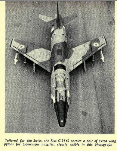

the Fiat G.91Y/T was two seat version of G.91Y for basic/advanced trainer
and the G.91Y/S project to meet Swiss Specifications for ground attack
aircraft.
http://www.flightglobal.com/pdfarchive/view/1971/1971%20-%200649.html?search=g.91yt

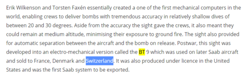

I found this in Jane's all the worlds aircraft 1973-1974.
Although for the Saab 105G, the BT9 dive bombing sight/computer originally entered Swedish air force service in 1944. I i bet the Y/S had a BT9 ballistic computer of some kind.
Here it is on the Saab 105G.
