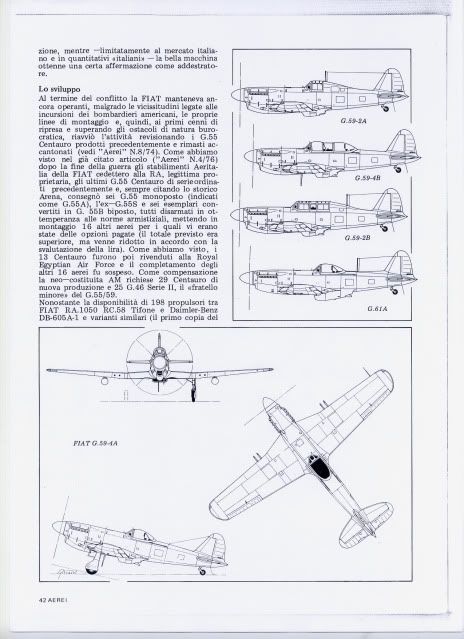

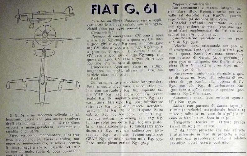

thanks to my friend Nando, so quick in sending the requested informations , here the page of an article in AEREI n 6, June 1976, article " G.59:L'ultimo a pistoni" by Carlo D'Agostino.
Page 42.

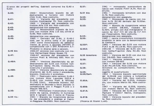

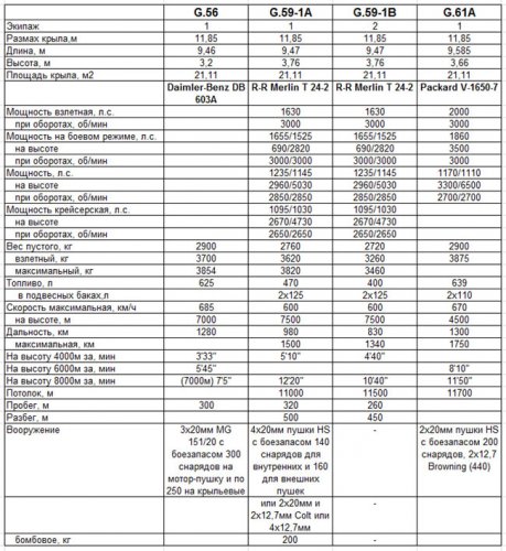

and at page 49 a list with Ing.Gabrielli projects mentioning at last the G 61A and B.
Interesting list, reporting also a G 53 , a ricognittore veloce biposto, and also a G55Z ... wow ... really a lot of intreresting subject I did not know at all.
the list is on reserch by Gianni Ludi.
The article about the G 61 reported only this:
"Intanto il tramonto del motore alternativo faceva annullare il progetto G.61, concepito inizialmente come caccia monoposto armato con due cannoni Hispano-Suiza MkII da 20 mm e due mitragliatrici M2 da 12,7."
That's all.
ciao
Giovanni
PS: Now I will start a search for material about the G 53 and the G55 with two engine, not the G58, and the G 55 Z ... interesting :)
