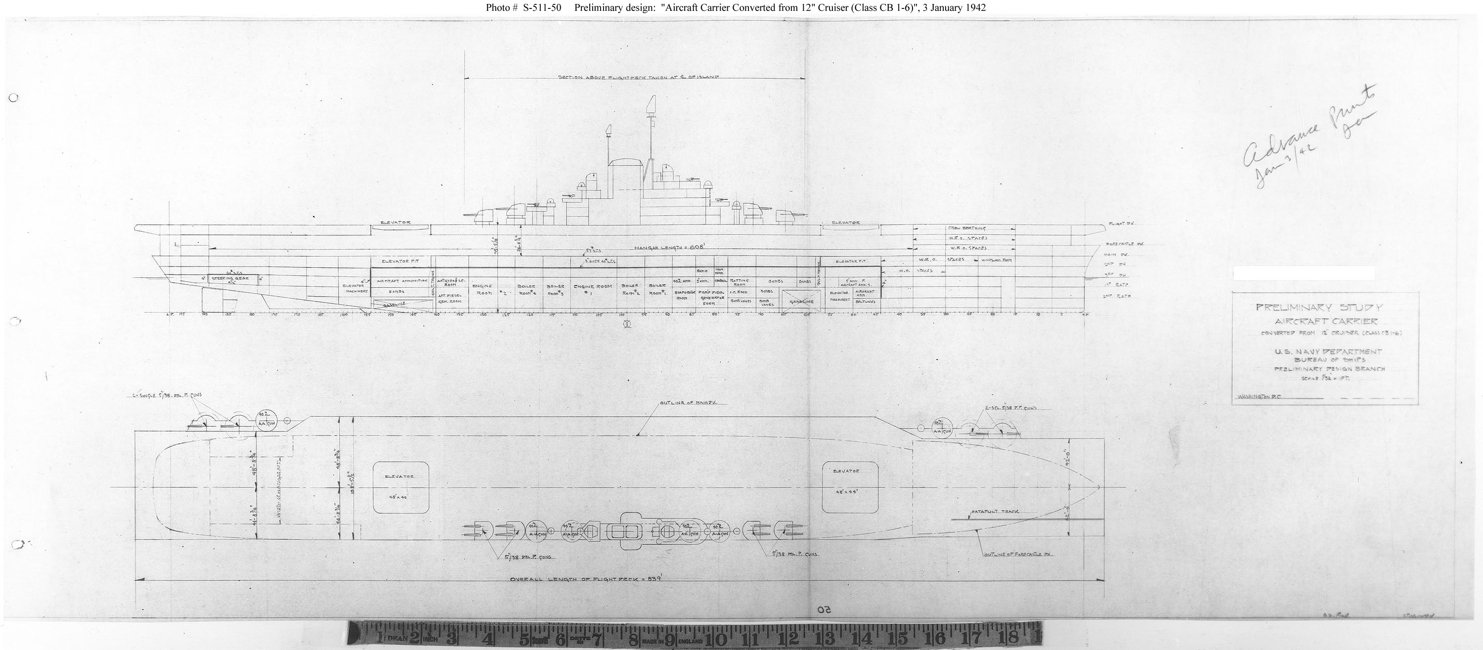

Due to a lack of capacity at BuShips, much of the design of the Alaskas was carried out by NYSB and was not completed and signed off by BuShips until May 1941.

So I really can't see the USN dropping the Alaskas for more Essex in 1941. They felt that they had enough already. Otherwise why not order more than 2 in Dec 1941?
Converting the Alaskas to carriers is even more of a waste of resources. Historical evidence, even then, was that a ship designed from the keel up as a carrier, made for a more efficient carrier, than some battlecruiser / cruiser conversion except where needs must (Independence class).
If you really must have more carriers ordered in 1941, replacing the Alaskas with more Essex is the route to go, subject to one proviso. Did NYSB in 1941 have the facilities to build 2 Essex simultaneously? While they built Saratoga, which suggests the availibility of 1 slip of the appropriate size, did they have 2?
Alaska-class carriers would be broadly comparable to Clemenceau & Foch - 839' x 108' flight deck (hull 791' 6" x 91' 9" waterline before bulging) Alaska; 869' x 168' flight deck (hull 781' x 104' waterline before bulging) Clem & Foch.
With a little bulging and an angled flight deck the Alaska-CV would be of similar displacement and overall beam - and would likely have similar air wing size.
They would certainly be an improvement over Colossus/Majestic class carriers - and over Saipans and Independences. If all 3 were ordered built/converted before launching they would form a decent class of ASW carriers in the USN or primary carriers for any other nation than the UK.

Building the ship is one thing. But how long to redesign? What gets priority for the design staff at NYSB (the CVL or the Alaska conversion)? How much structural work needs reworked (depends on when decisions are made). What priorities are given to them vis a vis a straight forward Essex build? All these things are pure speculation because it never happened.
Oh! My copy of Conway's says that Alaska was launched on 03.11.45. I got the data for the class for the last post from Wikipedia which says she was launched on 03.11.45. (The other dates match.) Which is correct?
Per Friedman & Navsource
Alaska laid down 17 Dec 1941, launched 15 Aug 1943 and commissioned 17 June 1944.
Guam laid down 2 Feb 1942, launched 12 Nov 1943 & commissioned 17 Sept 1944.
Maybe @Lascaris' proposal to build Alaska and Guam as aircraft carriers was inspired by the conversion of the 9 Cleveland class light cruisers to Independence class CVLs while they were building. As I've already written, all 9 Cleveland class were built by New York Shipbuilding and so were the 2 Sapian class CVLs.
And as I've noted NYSB built the Independence class because it already held contracts for building the Cleveland class cruisers on which they were based. 6 of those hulls had been laid down as cruisers (5 before PH) before the decision was taken to convert them to CVL. The two Saipans were meant to cover losses expected to occur. And with the experience of working the conversion of the Independence class it made sense for that contact to go to NYSB too.
Is CB-3 Hawaii completed as an aircraft carrier in your timeline?
The change is incidental, the TL is mostly European oriented. But one of the USN carriers is caught in the initial Japanese attack at Pearl and gets sunk. This causes enough of a panic that the proposed conversion of Alaska and Guam to carriers gets pushed forward by FDR alongside the Independence class CVLs. Hawaii is never completed instead the resources that went to her go to USS Kentucky which actually gets completed TTL.
I thought the issue was engines more then anything else, as in the us couldn't build more Essex classes because it was taped out on engines and boilers, were as the alaska conversation wouldn't use any more of the bottle neck then there always was.
