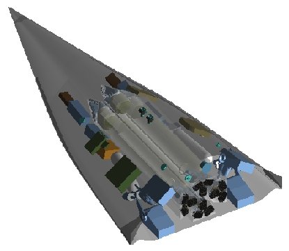

Well, this was Boeing's CAV. First pic is probably later variant, and it's damn hard to find many differences from LM proposal.

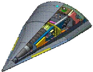

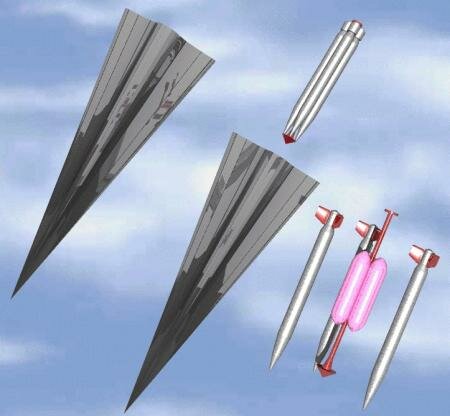

This is I presume truly fictional Andrews Space's CAV, the second pic, meanwhile, is from their report and may be closer to real stuff.

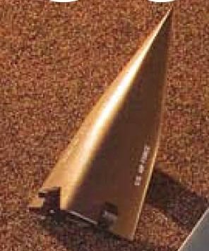

Third is Orbital sharp-edged CAV-H

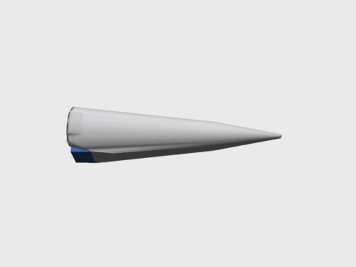

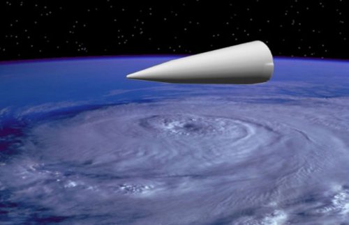

Lockheed CAV

CAV actually split into 2 sub-programs, CAV-L and CAV-H (low performance, and high performance - specifically crossrange maneuvering). The wedge and waverider shapes in flateric's posts were all for CAV-H, while the conics were CAV-L.
CAV-L became HTV-1X, and CAV-H became HTV-2X. HTV-1X became a dead end after they found they could not produce the desired shape with current carbon processes. Odd, since it was relatively simple (though it is not any of those shown by flateric).

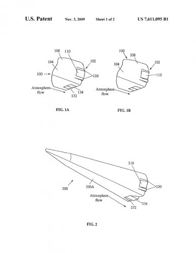

Boeing CAV patent
http://www.google.com/patents?id=ppnJAAAAEBAJ&printsec=abstract&zoom=4#v=onepage&q&f=false
