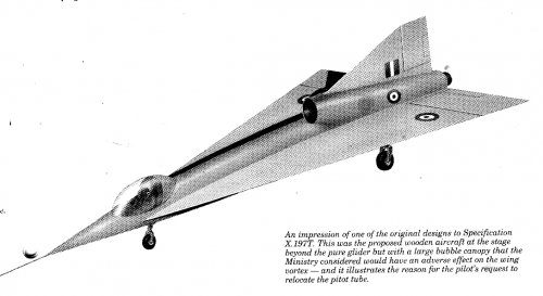

Maveric said:
...more info´s about the research glider ???
It looks like the Supermarine Type 573 experimental glider project or the Handley-Page HP-115 (in its first configuration, copy herewith), both responding to the spec. X197T issued in March 1959 to cover the design and the construction of an aircraft to investigate the low-speed characteristics of the slender delta wing.
Three other manufacturers also answered to this spec.: Bristol with its Type 215 project (configuration close to the HP-115'final config.), Fairey (Type number and configuration unk.) and Miles (Type number and configuration unk.).
Any information available on the two latter projects?
Philippe

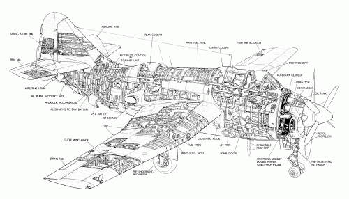

archipeppe said:
It possible to find any decent Gannet's cutaway?
There was something on the Flight Int'l archives for sure. I'll see if I can find a better one.

I think there are more cutaways of the Gannet lying around, but this is the first I could find.

That's a nice FG cutaway. Has anybody ever seen an S-2 Tracker cutaway?
Ryan's webpage has all the SACs which usually have inboard cutaway diagrams:
