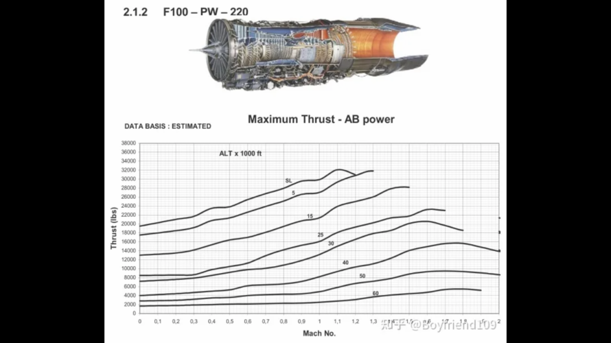

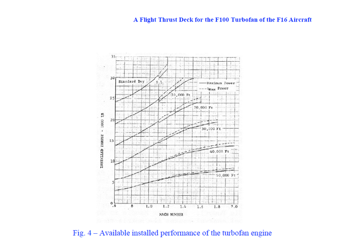

Hi gays. There is a Fig that shows the installed performance of F100(I guess it's F100-PW-200/220) in the paper" A FLIGHT THRUST DECK FOR THE F100 TURBOFAN OF THE F-16 AIRCRAFT" ?
Do anyone have information about installed performance of F110-GE-100 engine? 83GI@S[MZ%H{()@7{`RW]7E.png
Yes funny enough, in an old Key topic
HFFM data by Mav-JP and Raptor one

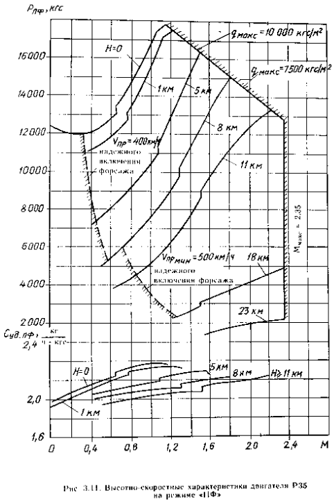

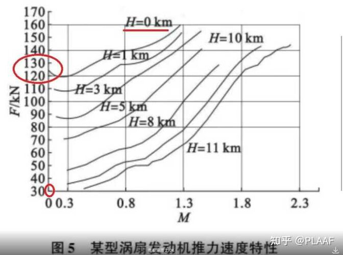

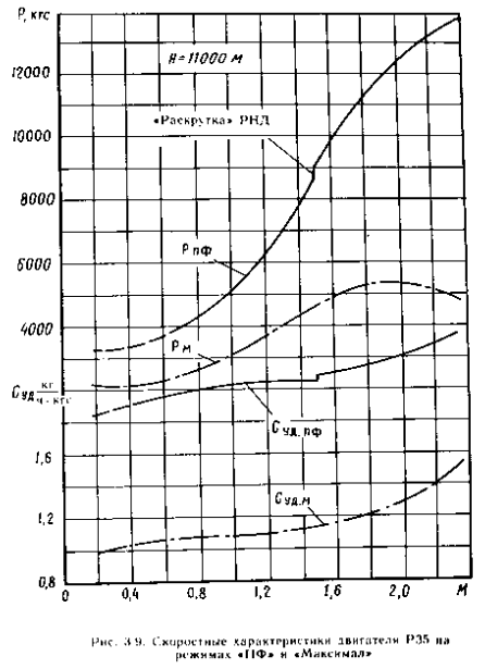

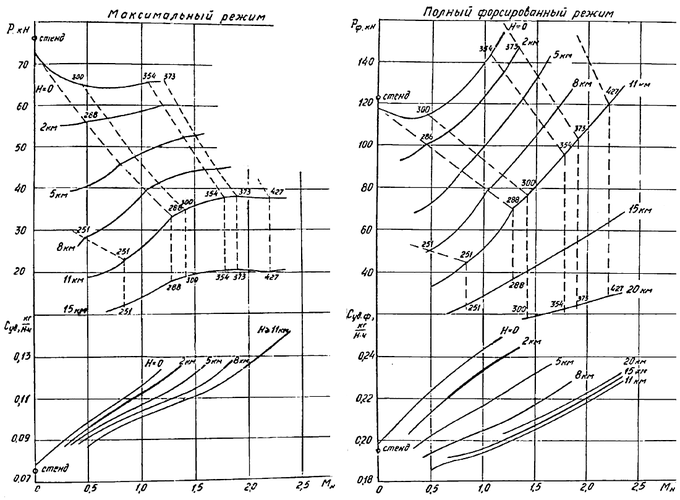

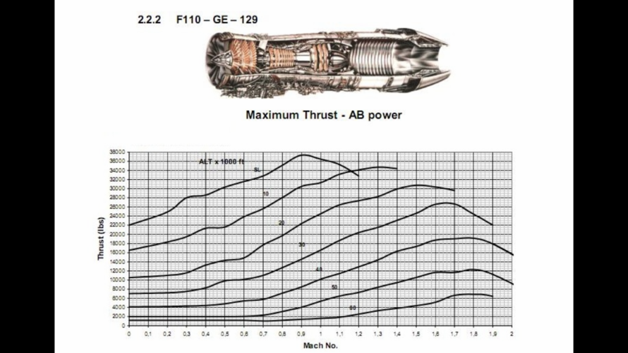

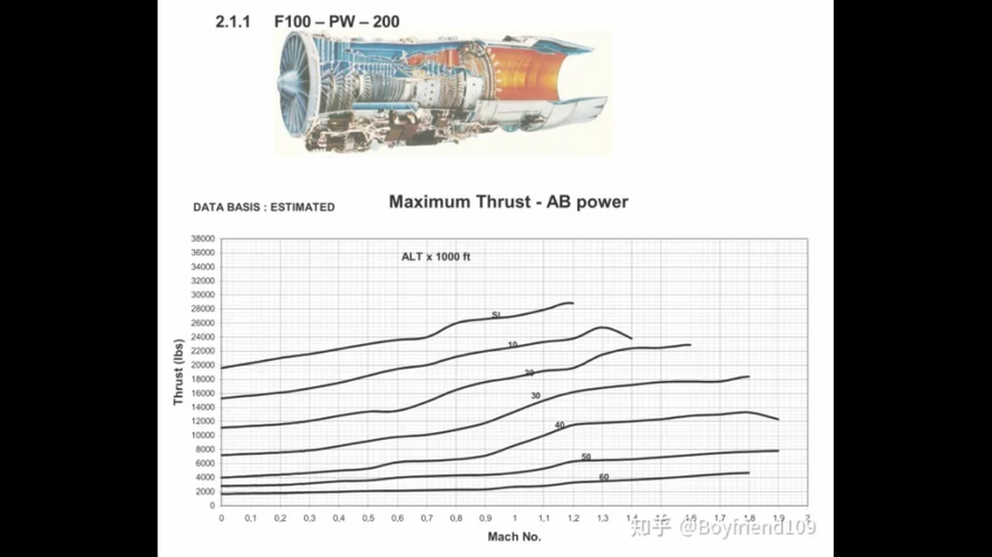

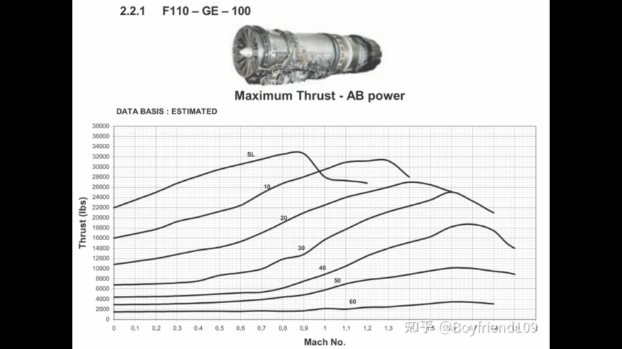

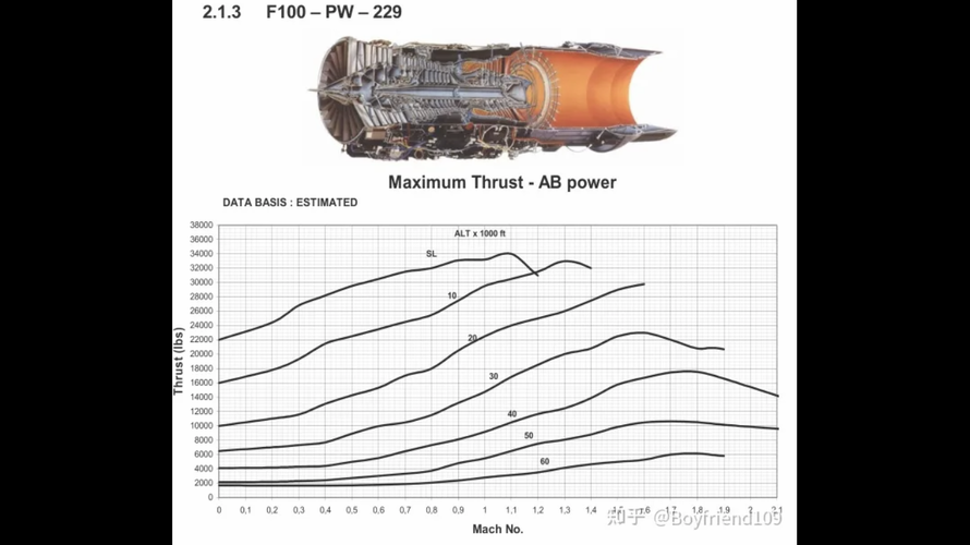

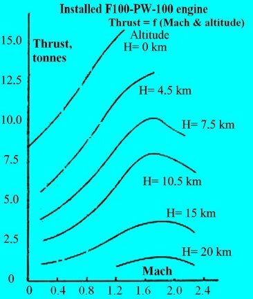

F100-pw-229, RD-33, R-35, Al-31f, and WS-10A
Along with another version of the F100-pw-200.
I figure since I already posted a bunch here this would be a good place for them that way you have ease of comparison. The AL-31f and WS-10a are installed in Flankers. All the F100 and F110 curves I e posted except the blue one are installed in a Viper.
