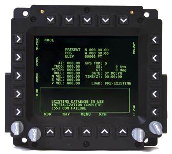

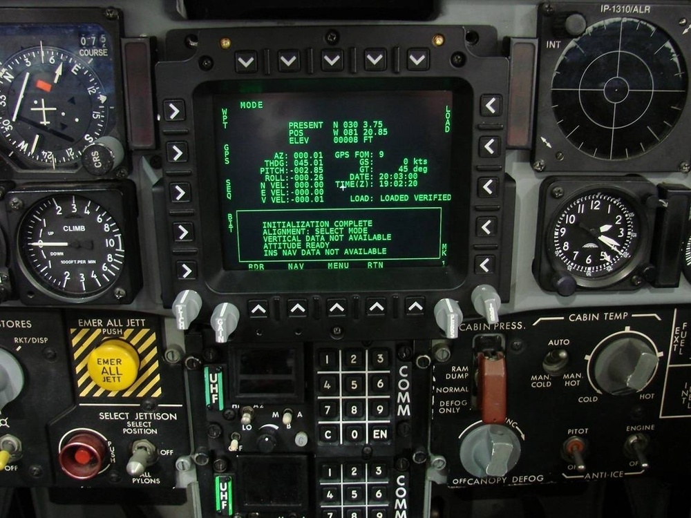

I have a technical question related to the F-5N avionics. Information available online suggests that these aircraft received the LN-260 INS/GPS with a small color MFD installed in the cockpit in the place previously occupied by the radar's CRT IP-1278 Data Display Indicator while in Swiss service.

My question is: if the original APQ-159 radar was replaced with the APG-69, did the above mentioned small color MFD provide any control of it, or were the radar projections displayed only on the F-5N's HUD?
![2012-12-17_181833-panel.jpg](/proxy.php?image=https%3A%2F%2F6d1f0d2e5a9f9c27cec8-28b934f7b0292a7dfd0ff5946ebc82f1.ssl.cf1.rackcdn.com%2F2012-12-17_181833-panel.jpg&hash=010f004b5d68607c0c06a05318df8a6f)
See also here:
![www.dvidshub.net](/proxy.php?image=https%3A%2F%2Fd1ldvf68ux039x.cloudfront.net%2Fthumbs%2Fphotos%2F1408%2F1478606%2F1000w_q95.jpg&hash=8f82e023e75e0b17c536c39afb0ada2b&return_error=1)
F-5N cockpit
The cockpit display of a new LN-260 inertial navigation system in an F-5N jet aircraft. (U.S. Navy photo/Released).
