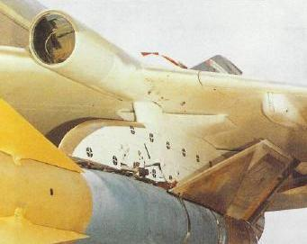

F-4EJ 301 has these black squares near the wing roots above the main pylons that aren't present on any other F-4EJs. Even other uniquely modified ones like 431

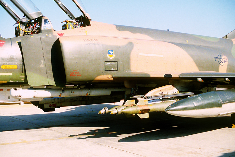

The black squares are present on some USAF F-4E's and that area is also where a TISEO pod would typically be mounted
Anyone have any idea what the black squares are?
Part of RWR/EW (Radar Warning Receiver/Electronic Warfare) gear (antenna). Initial F-4E F-4EJ & install was common with F-4J. JASDF 431 has upgraded Japanese EW installation and the antenna is moved to the leading edge of the wingtip. TISEO F-4E, slatted F-4E and slatted F-4S also had this antenna relocated to the wingtips.

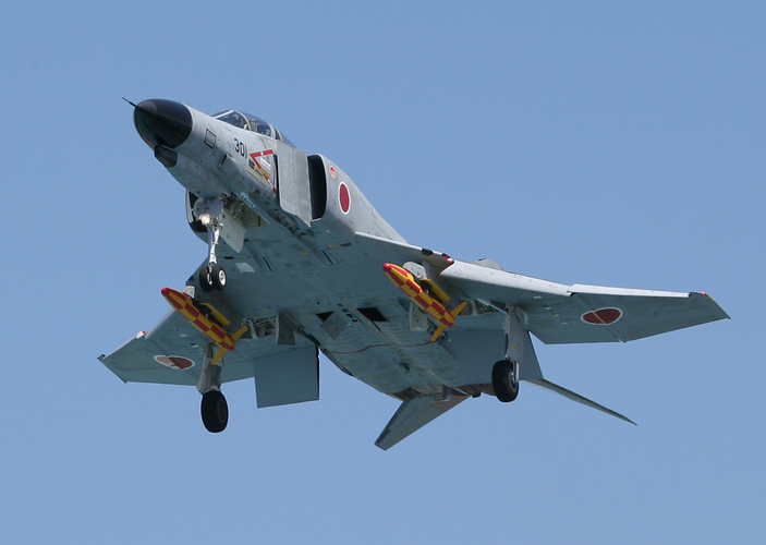

I found some more pics that are of interest.
View: https://twitter.com/t2Bluemyokochi/status/1630812303015940097
F-4EJ 301 with fixed camera pods and an F-104J with a bomb with some modified probe out of the front.
FqHPFgZagAAtSYp
FqHOvFkaYAAH0T6

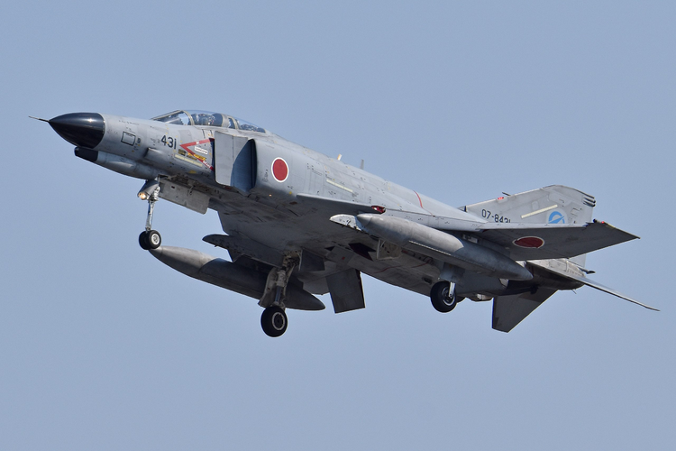

View: https://twitter.com/t2Bluemyokochi/status/1631022572593909766/
F-4EJ 431 with a movable camera pod.
FqKLs2sakAEklAQ

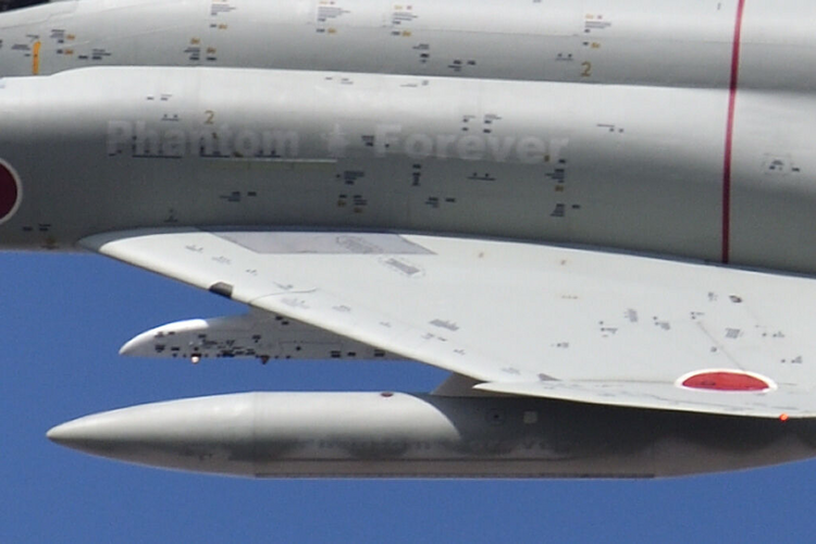

View: https://twitter.com/t2Bluemyokochi/status/1630743772970778624
FqGQxOxaIAIeH1A

The camera pods are definitely interesting and could be related to the extra controls set. As for the drone I couldn't find any solid info on it and maybe it's a predecessor to the Fuji TACOM.
