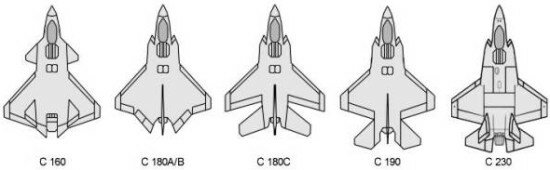

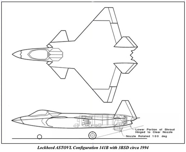

I believe that would be CALF which built upon the ASTOVL project. If they went forward without the CATOBAR requirement the Lockheed design would look quite different. Probably very close to their "Configuration 160" design which was the last before the addition of a carrier variant to the picture.
As explained to me by someone here the canard layout was better for the limited length imposed by the requirement it fit within a LHA/LHD elevator. When Lockheed switched to a layout with a more conventional tail performance probably suffered somewhat due to having to work within those dimensions.
So without the STOVL requirement I think a conventional layout would be selected by Lockheed, probably resembling a smaller, single engine F-22 in some respects as the F-35 does.

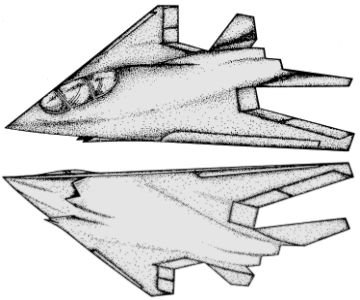

Judging from other projects Northrop's design (assuming they don't end up a supporting member in a team) would probably look a lot like a smaller F-23 with chin intake.
