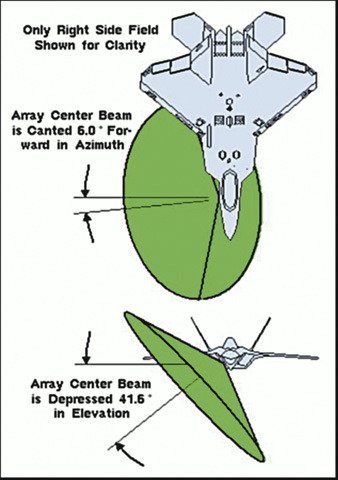

I don't get the move away from IRSTs, F-22 has space for one but it was never installed?
It went away along with the cheek and wing arrays (see below).
