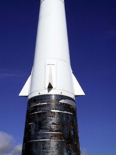

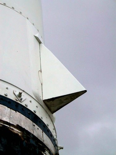

GeorgeA said:
Or more prosaically, the Sprint ABM second stage used external burning for attitude and divert control.
No it didn't. They tested it on Hibex/Upstage but Sprint used fins on the 2nd stage.
