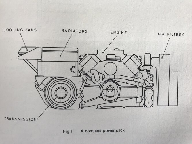

The resulting power-pack proposal, as used in the ENT concept, is shown in the attached image. The transverse engine with the cooling fans and radiators mounted above a compact transmission is almost identical in conception to the EuroPowerPack that uses the Renk HSWL 295TM transmission with the MTU883 engine.
