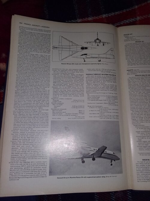

I looks through my Janes All the Worlds Aircraft volumes and 1975-1976 has no trace of Mirage 2000, 1978-1979 has drawing and photo of the first prototype. I don't have 1976-1977 or 1977-1978 which might have a drawing of the Mirage 2000 prior to first flight.
According to Paul Jackson in Modern Combat Aircraft Mirage (Ian Allan) the Mirage 2000 derived from the export-focused 1972 "Delta 1000" study.
