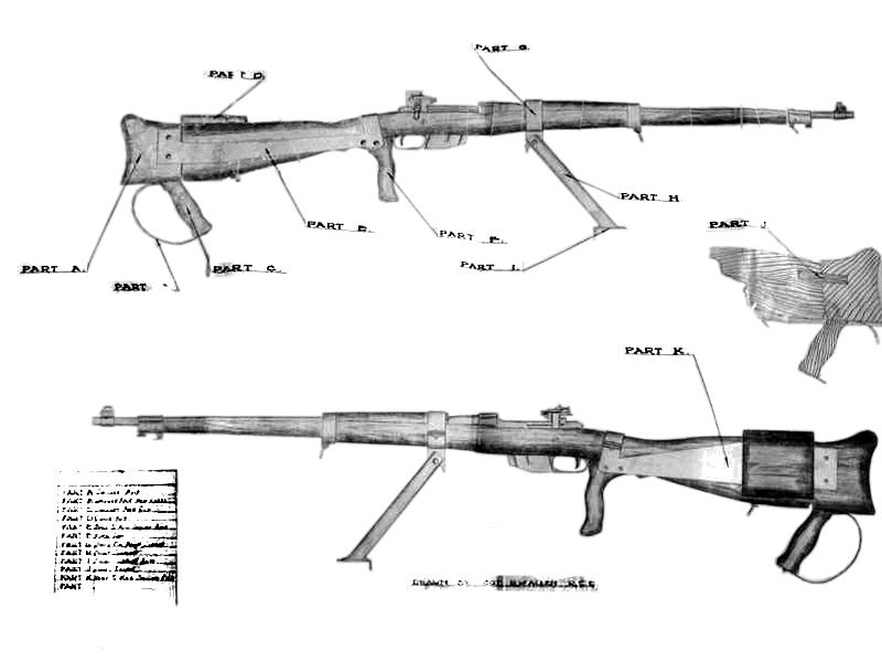

Two images are mounted - with no accompanying text (or image source noted). I'll link to those images below (since rifleman.org.uk is rather firm about its copyrights).
-- https://www.rifleman.org.uk/Images/Boys-Ross Training Rifle conversion.gif

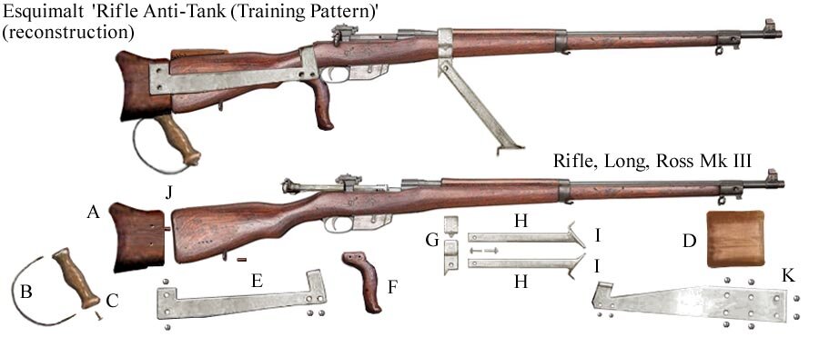

The first image is a parts diagram illustrated with photos of the 'Rifle Anti-Tank (Training Pattern)' conversion showing it from both left and right sides. Some of the labelling is a little hard to make out, so I've recreated these on the attached reconstruction artwork. Those parts letters correspond to the list below:
Part A = Extended butt
Part B = Rear grip hoop
Part C = Rear grip handle
Part D = Cheek pad
Part E = Butt extension plate (R)
Part F = Pistol grip
Part G = Bipod mount clamp
Part H = Bipod legs
Part I = Bipod feet
Part J = Dowel for Butt extension
Part K = Butt extension plate (L)
As will be seen from the reconstruction, the 'Rifle Anti-Tank (Training Pattern)' wasn't a slavish imitation of the shape of the Boys. Most likely, it was just a matter of getting a rough shape onto the range as quickly as possible (the Pacific Coast being in a bit of an invasion panic at that time).
