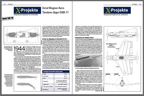

An interesting German project by Ernst Wagner featured in FliegerRevue X 65.
http://www.fliegerrevuex.aero/fliegerrevue-x-65/
From the magazine overview through Google Translate :
X-Projects: Wagner-propeller-hunter with tandem engine from 1944
From assemblies of the Messerschmitt Bf 109 with a new delta wing, Ernst Wagner constructed a fast, highly unusual fighter aircraft in 1944.

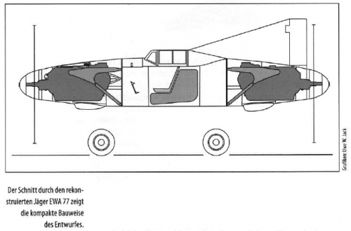

A good views.
Just a suggestion: Of this "project" only a sketch and some basisc data are known, obviously
submitted as a proposal to use components of the Bf 109 to produce a new and superior fighter.
Eve that article states, that the known data seem not to be coherent, but probably based on
the designers memories after the war.

Regarding the Ernst Wagner design. The caption says it's a 'reconstruction'. Is there a period drawing accompanying the article or is the magazine's drawing a speculative design?
but the vast majority were produced because the company employing the designers was required to submit designs for a government competition, not simply to keep the designers from being sent to the front.
At last an unbiased, educated statement! Back to secret, wacky projects, please!!!
newsdeskdan said:
...Is there a period drawing accompanying the article or is the magazine's drawing a speculative design?
The article says, that Ernst Wagner presented the design of a twin engined private aircraft with push-pull configuration
in 1958. And when introducing this design to the public, the designer mentioned, that it was based on this design for a
fighter, submitted to the German airforce in 1944 ... "intensive research of the author didn't bring out any original document,
nor about the company owned by Ernst Wagner back then ..."
The whole shown project is based on the Ernst Wagners memories, and the author of the article in the FR X points to some
details, where this memory obviously already was fading.
