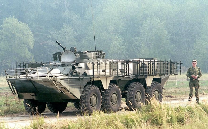

Actual up-armored BTRs look like this:

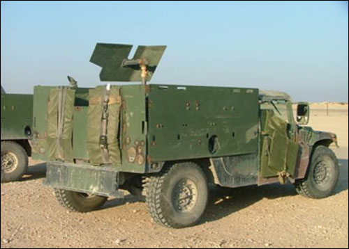

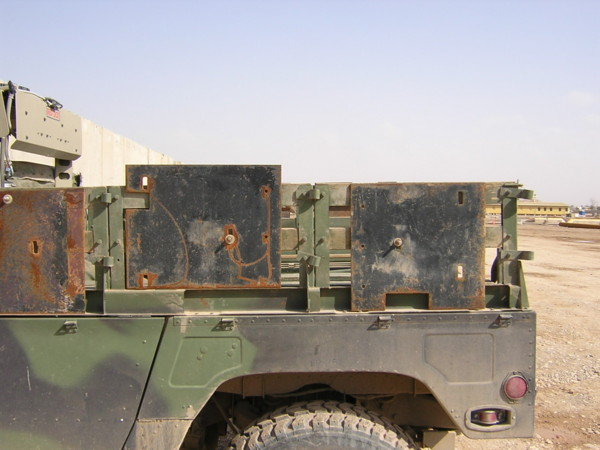

Most Naval Infantry and some VDV troops have significantly modernized equipment with slat/cage armor and such which protects against rockets. ERA is just the Russian form of Hillbilly Armor. Sometimes the soldiers know what they're doing and fill the ERA with rubber sheets instead of explosive to make an incredibly crude form of NERA I guess. Sometimes they don't and plaster a T-62's rubber fenders and stowage boxes with K-5. It's no different than the US Army slapping rusty Iraqi sheet metal and duct taping PASGT vests to their Humvees in 2004 in that case.

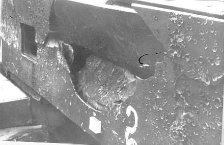

There is a certain minimum thickness or strength of material required for ERA backing and neither BTR nor Tigr meet the standard. Nor does BMP-1 or -2, as Soviet attempts to put Kontakt-1 on the BMP-2 showed with the picture I posted. Slat armor would work but that requires like...actual work. Not something a depot of the LDPR would be able to do since they are trained for BDR if trained at all, nor the Federal Army except for maybe a factory.
