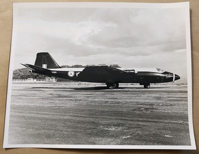

The prototype B.5, VX185, was converted from a PR.3 on the production line.
I wondered if anyone could confirm whether VX185 had the additional 14-inch section of the PR.3 or whether it was completed to the standard Canberra length?
VX185 was later converted to B(I).8 standard but the original nose section survives at East Fortune, but the aft bulkhead is ahead of where the longer ex-camera bay section would have been.
I am supposing that since VX185 became a B(I).8 that it probably was a standard bomber fuselage - but I'm just guessing here.
Having a look through what I can find in my Canberra references, I can't find dimensions for the B.5, but using my Mk.I eyeball and searching images of VX185 as it was completed (before B(I).8 conversion), it appears to match the length of a B.2.
Compare the following image with that of a PR.3. Click on the photograph of VX185 on the ebay page for a bigger one.
The section at East Fortune begins at the aft wall of the nose undercarriage bay; compare the ebay photograph of VX185 with the line on the PR.3 prototype VX181 photograph above and note the position of the engine intakes in relation to the nose gear doors.

I would say irrespective of whether the serial was re-assigned from a PR.3 or T.4 order, the B.5 was completed with a standard length fuselage (as we well know the wings were that of the B.6 variant).
Certainly photographic evidence of VX185 as the B(I).8 prototype shows no sign of the longer camera bay behind the main bulkhead where the noses were switched.
