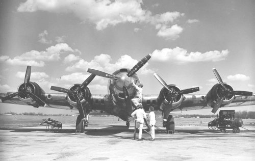

Are there any high res images within the hands of members of this venue that relate to engine test bed aircraft? Here's two examples. -SP

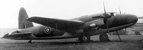

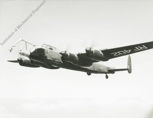

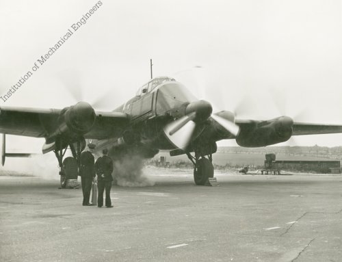

Here are two.+2

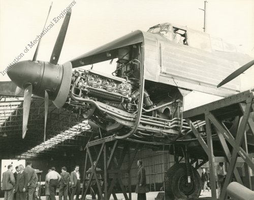

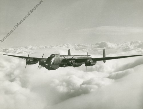

looks strange with the nose cut away.
SX973 Avro Lincoln and a Napier Nomad 1.
Source: Vliegwereld, June 18th 1951.

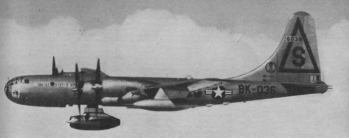

B-50 in use as a J-57 test bed.

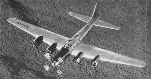

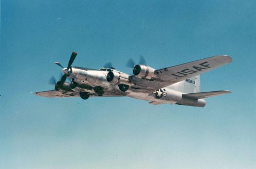

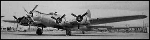

The most unusual conversions were three B-17Gs converted to engine test beds. The nose section was removed and replaced with a strengthened mount for a fifth engine. The Pratt & Whitney XT-34, Wright XT-35, Wright R-3350 and Allison T-56 engines were all flight tested on JB-17Gs.
From http://www.nationalmuseum.af.mil/factsheets/factsheet.asp?id=2455
Wright's R3350 was a radial piston-engine, that leaves the Allison T-56. I guess.
Source for XT-34: http://en.wikipedia.org/wiki/B-17_Flying_Fortress#See_also I think this is the same configuration as shown in Steve's first picture.
Source for XT-35: http://www.pointniner.com/2008/08/single-engine-b-17-other-rare-aircraft.html
Source for R-3350: http://www.strijdbewijs.nl/birds/b17/p5.htm

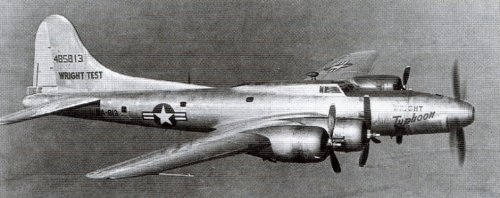

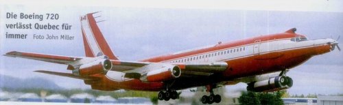

And another one, just found today in the latest Flugzeug Classic:

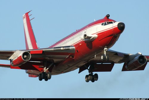

The Boeing 720 C-FETB, which was used by P & W Canada as a testbed
and fitted with PW150 turboprop engine in the nose.

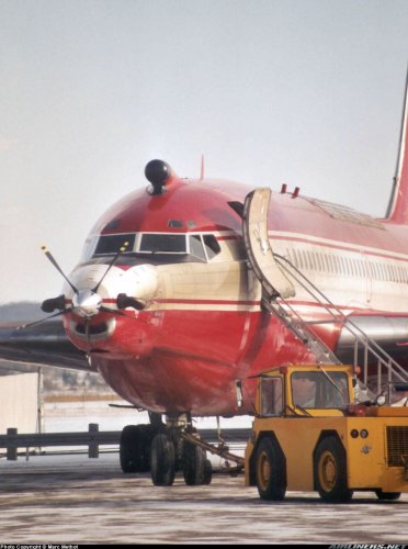

Two more pics of the same aircraft from my hard disk:

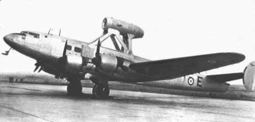

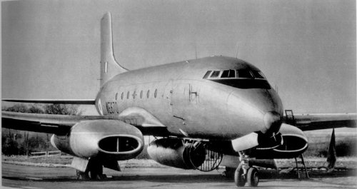

From J.-C.Fayer "Les Prototypes De L'Aviation Francais" via the Aviation-Ancienne forum,
the SNCASE SE.161 Languedoc as flying test rig for the ATAR:

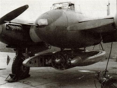

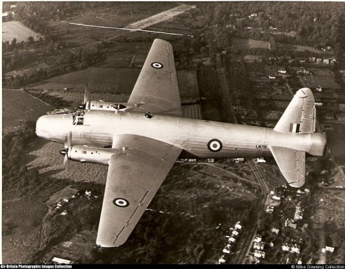

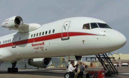

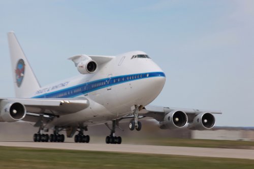

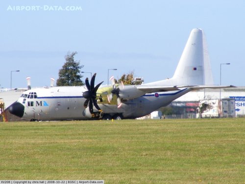

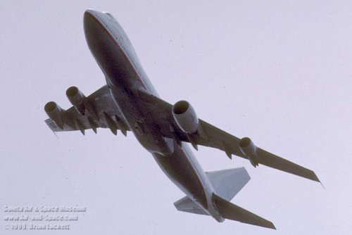

747 with GE90

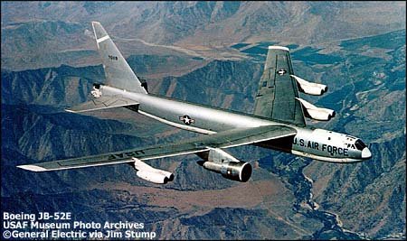

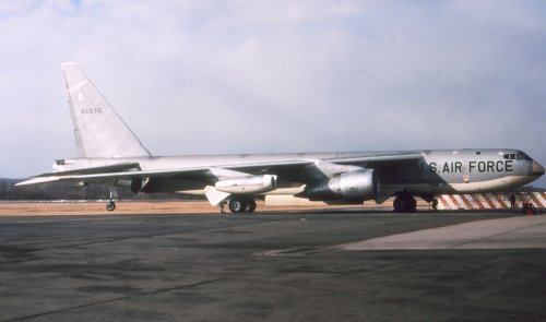

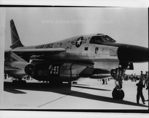

B-58 with J93 pod.

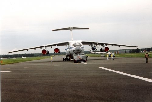

Ilyushin Il-76LL registered RA-76529 at Farnborough on 6 September 1994.
Fitted with a D-236T propfan it was awaiting the cutters torch at Zhukovsky in the summer of 2002.

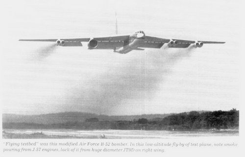

sferrin said:

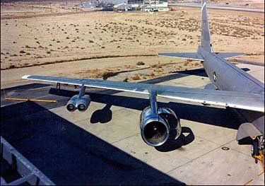

B-52 with TF-39 (C-5's engine).
... and with the B 747 engine (JT9D)
(from D.J.Ingells "747-Story Of THe Boeing Super Jet")
