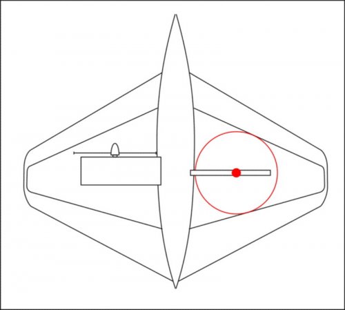

Haven't found any 3-view still yet, but using the side and front view from the Elytron site, I tried to
tinker a provisional upper side view and, although I'm not sure, the pure projection of the rotoprops
may been clear.Depends on the position of the rotation axis, of course ..

Doesn't the second to last pic in the original post show a view from the top down with the rotors in hover mode? Seems to show quite a lot of clearance between the rotor disk and the wing surfaces.

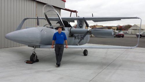

I believe there has been a set back with this program with the demonstrator/prototype having crashed. Thankfully the pilot survived the crash.
