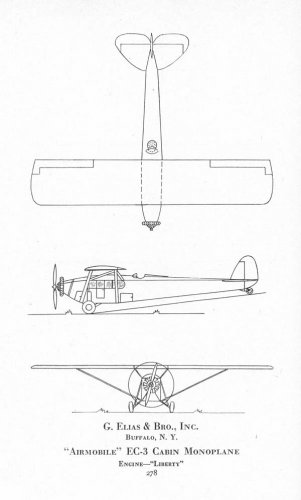

we know this company,it designed the EC-3 Airmobile,it was a huge high-wing monoplane,
if some has a drawing to it from Aircraft Yearbook 1929,all info about it;
EC-3 Airmobile 1929 = Shown in the plans section of the 1929 Aircraft Yearbook, this was huge, high-wing monoplane with the pilot in an open cockpit behind the wing, and with a cabin for perhaps four to six passengers. Elias has presented many problems for researchers, and this is another of them: (1) the big radial engine shown in the three-view belies its description of a "Liberty;" (2) the model merger of the EC line of small, low-powered sportplanes with the Airmobile biplane is odd; (3) no dimensions are shown, but it seems to be in the general size of the 1927 Airmobile biplane. It was undoubtedly never built.
http://www.aerofiles.com/_e.html
G. Elias & Brothers, Inc. established in 1881 in Buffalo, NY as a timber concern (later in 1919 created an aircraft department and then renamed it the Elias Aircraft & Manufacturing Corporation) with its first design, an experimental Army training airplane appearing in 1921. A Navy trainer was also designed in the same year.
The EC3, a passenger aircraft, is below, but was never built:

Brilliant! I didn't have an illustration for the EC-3.

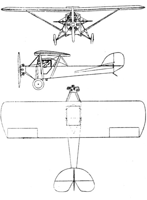

Thank you Skyblazer, it was the Marines and not the Navy. I was referencing a minimal description of some of Elias' work in 1921 from an Aerial Age reference that said Army and Navy aircraft. But you are correct. I also have a three view of the earlier EC-1 Aircoupe with dimensions if I can find it I'll post it.

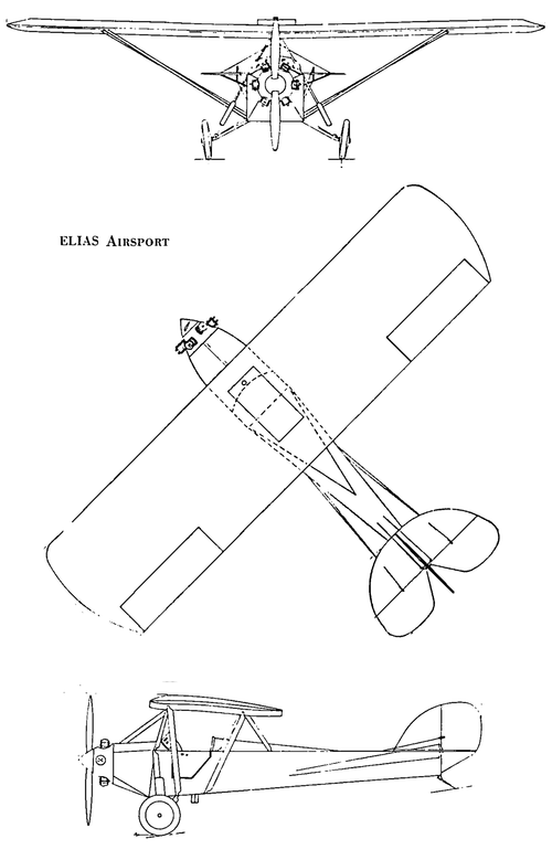

that leave a mysterious question,what about EC-2,was it exist ?.
I was wondering exactly the same thing only tonight... EC-1 Aircoupe [X3981] was later modified as the EC-1 Airsport, an open-cockpit version. Makes me wonder if this may have been in fact "EC-2".
Here's a GA drawing of the EC-1 Aircoupe taken from Le Document aéronautique March,1929.
