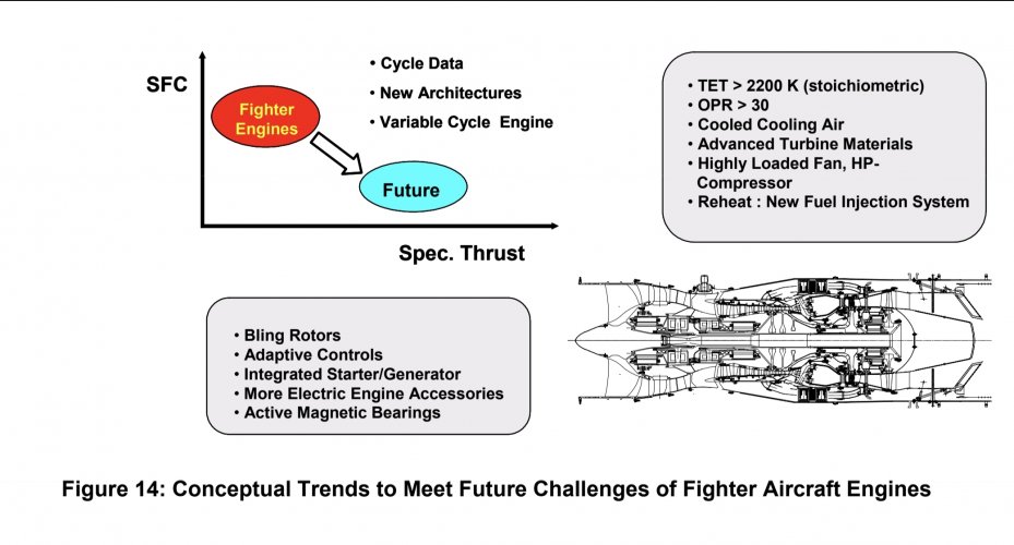

The attached document has, toward its end, reference to potential versions of the EJ200 and its growth curve. Also reproduced here is the text from a 1996 Flight International Article talking about thrust vectoring and potential growth paths entitled ITP draws up thrust-vector plan for EJ 200.

  • EJ200 ASME.pdf
