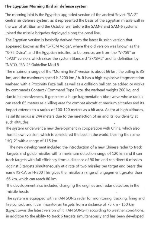

They had an indigenous SA-2, any upgrade projects?
Yes. In fact the most advanced form of SA-2 so far. Egyptian goes phased array for it
The radar tho seems to be deriviative from Chinese H-200 Radar for KS-1 system.
Nonetheless this one is far superior to any Eastern Europe or Russian upgrades for SA-2 system. It address key weaknesses in old S-75 system, namely the angle tracking method and numbers of target and missile channels.
The old S-75 use Track while scan method which roughly two conical scan radar in two dimensions (azimuth and elevation) This method works good but vulnerable to inverse gain jamming and sensitive to target RCS scintillation phenomenon, where the fluctuation of target RCS affects the tracking quality of the radar which makes the missile oversteers or rather inaccurate (thus large warheads).
This new phased array is monopulse which eliminates above weaknesses, also making it less susceptible to jamming and maybe even provide LPI capability as it can have low sidelobe. Agile beamsteering allows tracking and engagement of multiple targets simultaneously, something SNR-75 can only dream of.

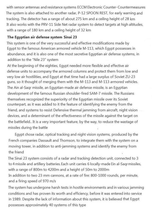

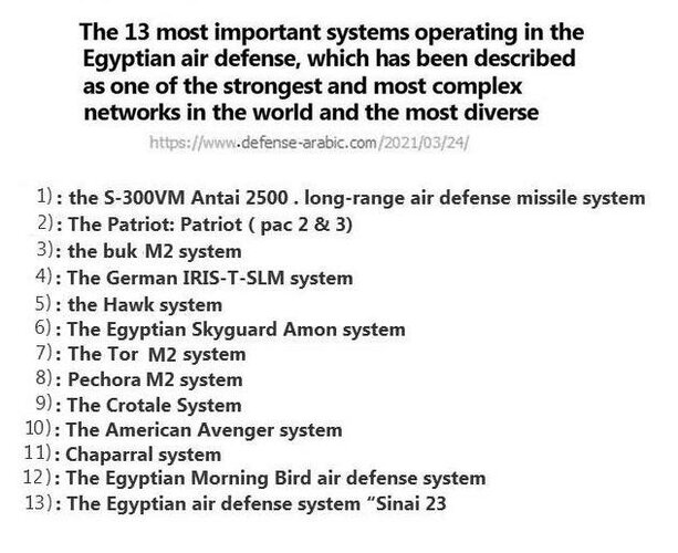

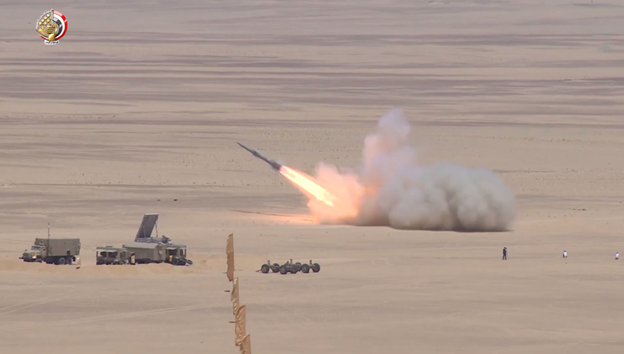

Sources (not to be pretentious or anything, i just dont have enough sources to write an article about Egyptian SAM capabilities)
Dear member Gaafar here are some elements found on defense-arabic website, which we need to translate to all of us, members of SPF.with the help of google translator, we surely arrive so it is an article about the Egyptian air defense systems especially the SA-2 Morning Bird and Sinai 23.
Tayyr Al Sabah translates to Morning Bird in english, do you have anything else brother?
Sorry, I have nothing on your subject, I found your post, interesting with a simple search on the net, the site defense-arab appears, I made a translation it was not difficult ,when we want we can.But personally I have no other information on morning bird.search you find.
