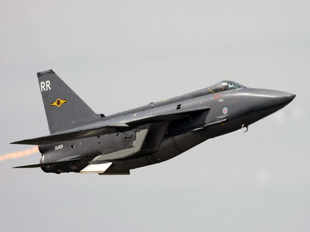

Sometime in 1987, a djinn walks into BAe's offices and promises them infinite money if they will adhere to the following conditions:
1) The English Electric Lightning must be maintained in service and upgraded to the limit.
2) The overall shape of the airplane cannot change. This means e.g. no single-engine variants, no swing-wings, but existing upgrade paths including F.2 to F.2a conversions are allowed.
3) Since financial concerns will be a non-issue, political and service objections to maintaining or increasing current Lightning force levels will be magically handwaved.
How do you manage the programme?
In 1987, I would doubt you could build more Lightnings, as all the tooling is presumably long gone. If you wanted to make new, I think it would be as easy to build EAPs instead.
You could probably fit Blue Vixen in the nosecone replacing AI23. AMRAAM replacing Red Top/Firestreak. PW1120 to replace the Avon engine?
Remember, the Djinn brings infinite money, so you can reopen the line irrespective of cost and production volume.

  • Call all birds back for a full rebuild to zero hours. New spars, maybe new wing and fuselage skins, whole nine yards. While we're at it, let's readjust the area ruling and the wings.
  • Replace Avons with EJ200s (may have to wait a bit for this step, EJs weren't available till 1991), RB199s are not a step up power wise but would greatly improve fuel economy and are close enough to the same weight as EJs for weight and balance purposes. EJs make 25% more thrust than the Avons at full reheat, but only ~8% more at MIL.
  • Blue Vixen radar, Skyflash missiles under the wings, ASRAAM if it's available yet (AIM-9L if it's not) and FFS give the cheeks Y racks like a Crusader so you can carry 4x Skyflash and 4x ASRAAM/Sidewinders like a real fighter.
  • Might replace the guns with Taildog SRAAMs if I have infinite money to make the "gun that shoots around corners", assume fitting 6-8x Taildogs in place of the guns (6x Taildog would be pretty close to the weight of 2x Aden w/200rds each, right at 900lbs). This does presume a 100% Interceptor role, but if the whole gun tray is removable as a unit then a separate unit with Taildog could be made to swap in. Air policing is useful to have a gun to shout "HEY, STUPID!!!" at someone not responding to the radio calls or a fighter blasting across their nose, but for wartime interception I'd rather have the Taildogs.
For all those suggesting a radar upgrade - does Blue Vixen or APG-65 fit in the intake centrebody?
Remember that unlike the Crusader, the existing missiles hang off of racks that plug into a drop-out weapons avionics/accessories pack; they are not integral with the fuselage. Do you have sufficient clearance on a Y rack to fit two missiles per side without running into interference problems with the wings? Do you have sufficient strength in the mounting point to take a Y rack with two missiles?
Are you REALLY sure you want to give up the guns? They were reinstalled for a reason, if only for the ability to take a shot when all the missiles had been used up.
How much room are six to eight Taildogs going to take up? Remember, just aft of the belly-bulge gun bay is a sh**load of jet fuel. Are you really sure you want to mount missile launchers there?
Sorry, the premise is so flawed
Yes, I know that - take a look at the title of the post. I'm having a bit of fun here.
Blue Vixen has a very small antenna, compare SHAR with a late model AV8B+ with the radar out of a Hornet (and even then, that antenna was apparently cut down in diameter). Frustrated as hell that I cannot find the antenna diameter of Blue Vixen online anywhere.
Two Sidewinders are a bit heavier than a single Red Top. I haven't seen any reference for how heavy the Crusader Y rack is, but I'm guessing in the 200lb minimum range. But that also means replacing all of the Red Top bits in the pack with 1980s era Sidewinder/Skyflash bits out of likely an F-4M and/or Tornado IDS, so I'm willing to bet we can save a significant amount of weight and volume there.
When you only have two missiles, you need a third attack.
This would have 8 missiles before we get to the Taildogs. 4x Skyflash and 4x Sidewinders.
Taildogs are 165mm diameter and 2.75m long. The launch tube is probably 180mm diameter. And you can add a blast deflector to not roast the jet fuel on Taildog launch.
plus, we can probably move some of that fuel around as part of the area rule revisions.
That's the antenna. Now, have you allowed room for everything BEHIND it?
