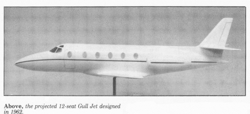

I came across an article in the september 1984 edition
of 'Aeroplane Monthly', about Edgar Percival, who had died
earlier that year. In the article I found this :-
"In 1962 he [Edgar Percival] designed the Percival Gull Jet, a 12-place jet-engined executive aircraft with a cruising speed of 565 m.p.h. The Percival STOL Jet followed in 1968 and the Gull Twelve, a twin turbine-engined general purpose STOL aircraft, in 1970."
Does anyone have anything more on these designs?
There was also an image of the Percival Gull Jet, see below.

Cool pic. The Percival design number that could correspond to the Gull Jet is the Model 117, described as an "Orpheus-powered executive transport" but of course this needs confirmation.

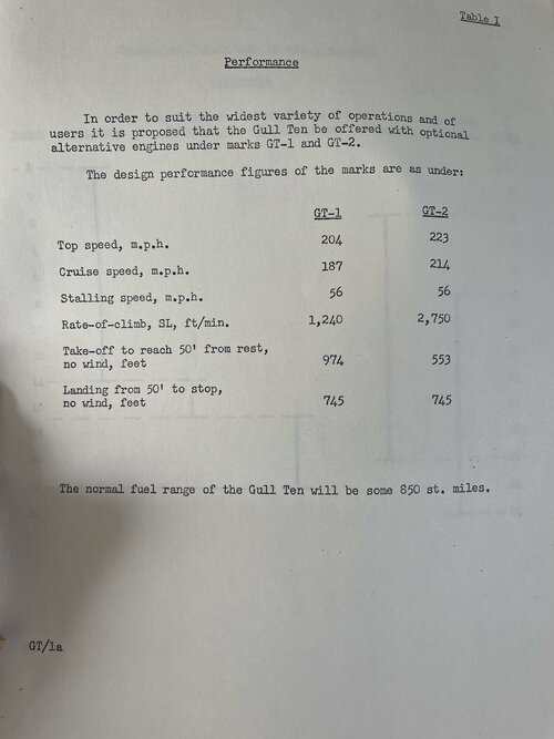

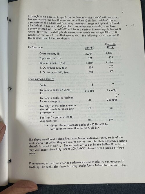

They also have a file on the Gull Ten project, a multi-purpose STOL aircraft which seems to correspond to your 1968 model:
They seem to have received Mr. Percival's own private collection, in fact:
Can any Aussie forum member have access to these and let us know a little more?

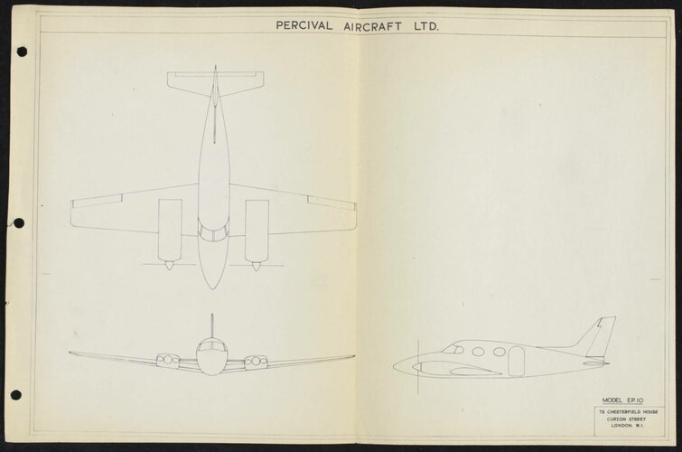

I also see a reference to an 'EP.10', which seems to be a
twin-engined light plane....

I noted that 'EP 10-J' designation too. Why the suffix, I wondered? Is this a twin jet light plane? :eek:
Unless the "J" stands for the customer, which leaves only Jordan as a likely (?) candidate...

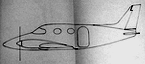

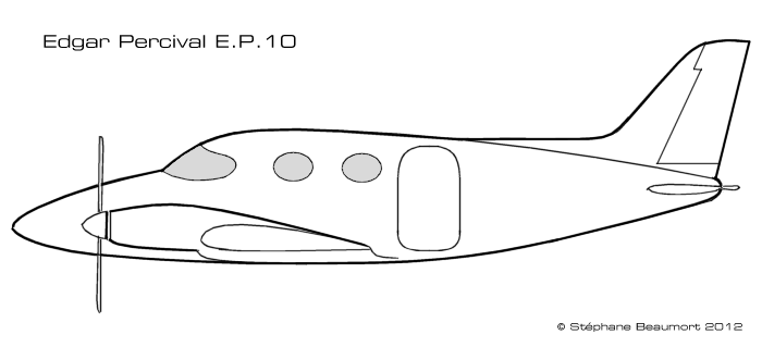

In fact, thanks to your "amateurish effort", I was able to produce (in some even more amateurish fashion...) a clean profile view of the E.P.10.
I tried to correct the view a bit, since the original photo was slanted and the right page a little narrow compared to the left one... Yet I can't guarantee 100% accuracy here. It's more of a working image to start from than a definitive blueprint!
Thanks, Star......
Right, speculation time, any ideas on size, number of passengers, etc.?
I'm thinking equivalent to the Beagle 206, or maybe a little larger,
two more passengers, maybe, perhaps pressurised?

Very interesting Indeed, many thanks for posting, are there any drawings of Percival's Gull Ten design (EP.10?)
cheers, Joe
