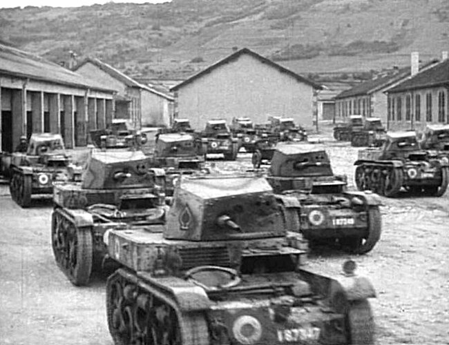

And this was the AMR 35, a light tank armed with the same Hotchkiss 13.2mm HMG. The Brandt 80mm projector-grenade would have given it a limited capability to engage much heavier armored fighting vehicles.
