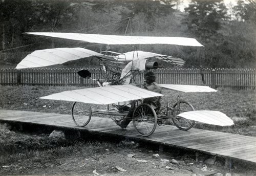

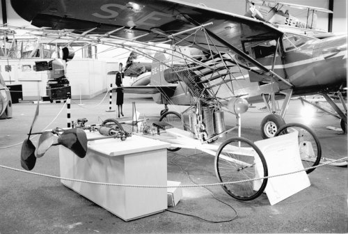

Mr. C.R. Nyberg was built the first airplane in Sweden,it was powered by a steam engine,it appeared in two variants.

I have a book about these, want any more info?
Btw they never flew XD
OK dear Blockhaj,please send it and if there was anther airplane to this designer ?.
Couldnt find the book im afraid, but there is some info from the Book, Svenska Flygplan about it. Apparently it could fly, just not with the pilot, how this was achieved is not known. It had a power to weight ratio that was better than the Wright flyer. Nyberg stopped his experiments in 1909.

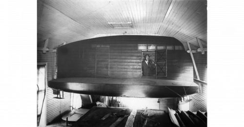

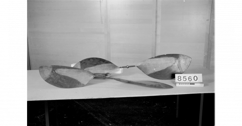

Here are more pics and some weird boat thing he built

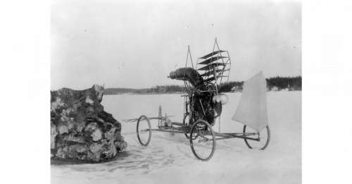

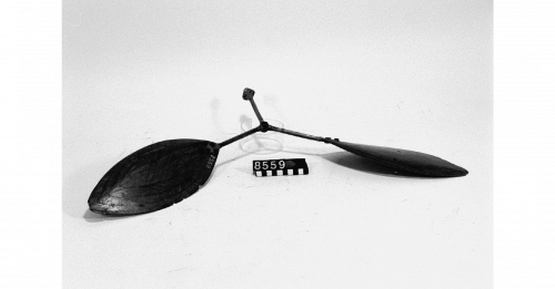

I was interested in Nyberg's curious looking engines and found this picture of one of his aircraft without its engine insulation and covering here: https://digitaltmuseum.se/021026305891/rorangpanna-med-kondensor?i=0&aq=owner%3A%22S-TEK%22+name%3A%22df46ba8b-1770-4290-b42d-4389b8c75ca2%22
The unusual shape that resembles a turbine exhaust is a large coil of tubing probably surrounding a torch for boiling water to generate steam. Nyberg was an inventor and manufacturer of blowtorches.
The translated text with the picture:
"Pipe boiler, with condenser
Pipe boiler with condenser for steam engine of 10 hkr. Equal parts of the steam engine. Comprising of steam boiler with water tank, fuel tank for burner, condenser and cylinder for steam engine, etc.
Label description: "10 hkr Twin Shaker. Skeleton 28 kg. Total Weight with Shafts and Propellers kg 7. Vapor Pressure: (Upper Heat.) Half Fill" 9 1/2: Repeat per Second 36. Total Weight of Machine and Boiler with Fuel for 10 my. once 50 kg. "

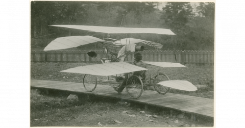

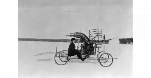

Tested on a circular track in his backyard …..
Why does that remind me of a U-control model?
Would that allow for remote-pilot testing?
