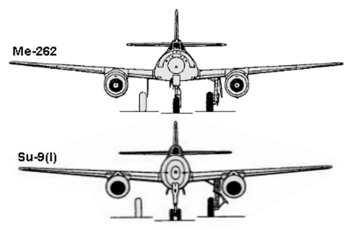

We can talk here about the Sukhoi early series, Su 9,11 & 13,
- Su-9 (Aircraft L) was a single seat jet fighter project,large canopy and fate
fuselage,and smalled in lengtha little to thenext entry,later developed to
the Aircraft K,1945
- Su-9 (Aircraft K) was a single seat jet fighter,based on Messerschmitt Me.262,
the engines were mounted under a trapezoidal straight wing,RD-10 jets,1945
- Su-9T was a two-seat trainer fighter project,also powered by two RD-10
engines,1946
- Su-9 (Second prototype) developed from first one,and it was to be powered
by two RD-10 augmented engines,the RD-10 augmented version was developed
by the Sukhoi Design Bureau in cooperation with the TslAM,1946
- Su-9 was a single seat jet fighter project,powered by two RD-10 engines,
which mounted in the wing,1946
- Su-9 was a single seat jet fighter project,improved by fitted with thorium
radar,powered by two RD-14 engines,1947

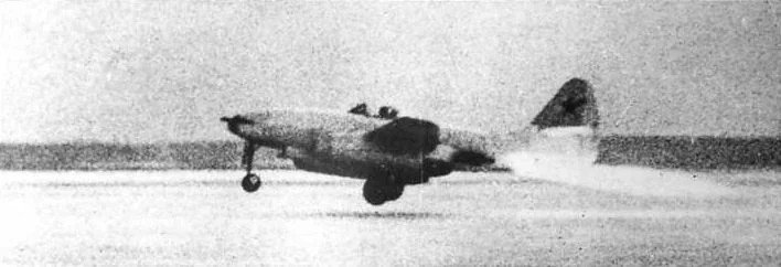

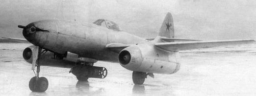

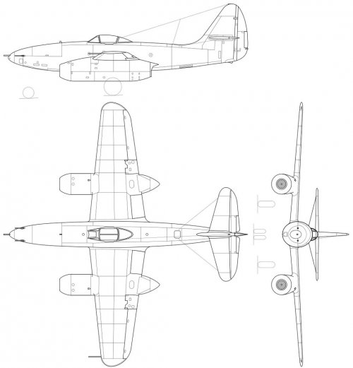

Specifications for Su-9
  1. Engine: 2x RD-10 axial flow turbojets with a thrust of 910 kg each
  2. Wing Span: 11.21 m
  3. Length: 10.57 m
  4. Height: 3.72 m
  5. Weight: Empty 4,060 kg / Loaded 6,380 kg
  6. Maximum Speed: 900 km/h
    Range: 1,140 km​
    Crew: 1Armament: 1x 37mm cannon / 2x 23mm machine guns

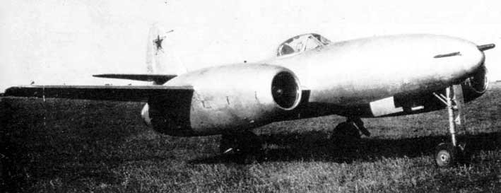

History:

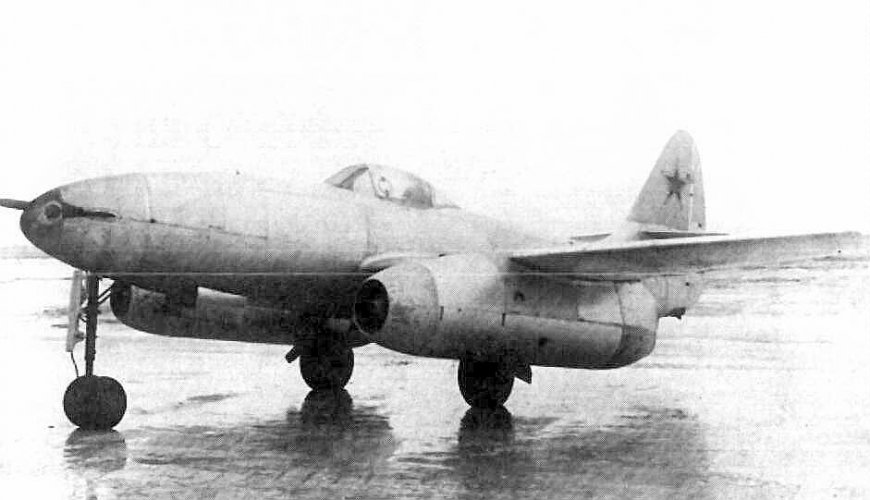

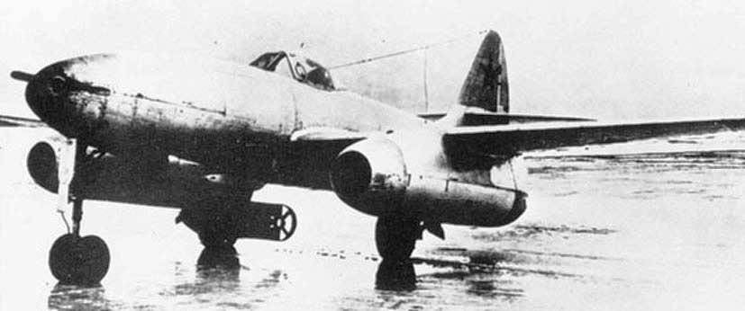

Designed by P.O.Sukhoj and included the crash program in 1945. Given authorisation in May 1944 for two prototypes and one static-test airframe. The Sukhoi Su 9 was by far the best of the first generation of Soviet jets and as good if not better as any thing in the West at the time.
Thought of as a copy of the Me 262 because of it's lay out, the aircraft was of a completely indigenous design, the Su 9 had it's first flight in August 1946, flown by G.Kochyetkov. One prototype was demonstrated to the world at the Tushino airforce parade on the 3/7/1947. The NII considered the Su-9 so good it recommended series-production as soon as possible, but the Su-9 never went into production as it's resemblance to the German Me 262 made the authorities (Stalin) uncomfortable and would lead in the end to Sukhoj's design bureau being closed in November 1949 and Sukhoj "falling out of favour" until the death of Stalin.

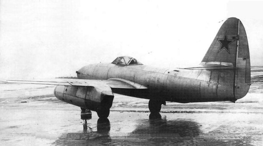

Improvements were made to the Su-9 in late 1946, resulting in the Su-11. Little changed to the Su-9 apart the fitting of two Lyulka TR-1 engines (the first aircraft to be fitted with Lyulka turbojet engines). The Su-11 had it's maiden flight on 28/5/1947, as with the Su-9 an outstanding aircraft, but a jealous A.S.Yakovlev told Stalin "Copy of the Me 262 and dangerous to fly".

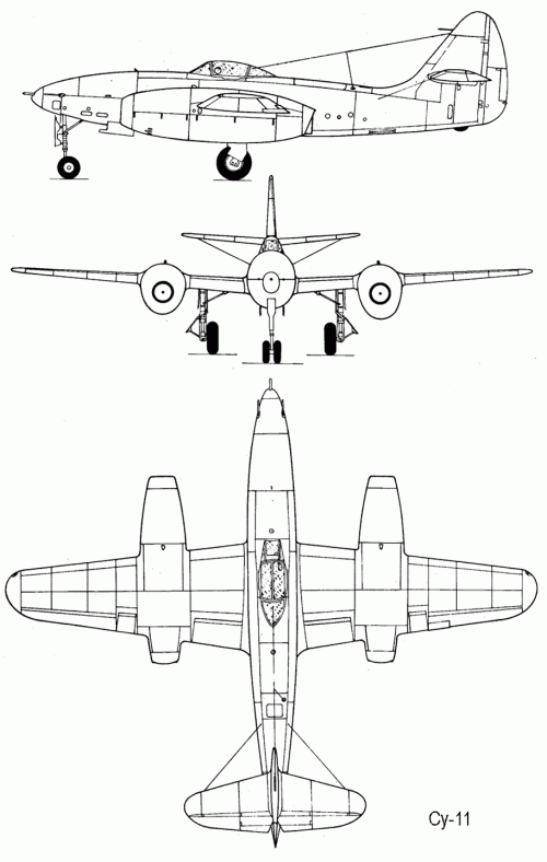

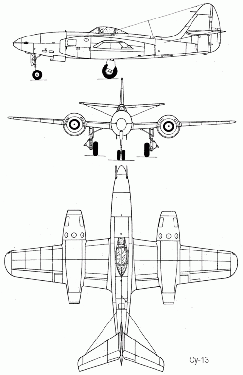

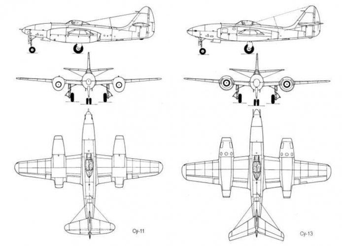

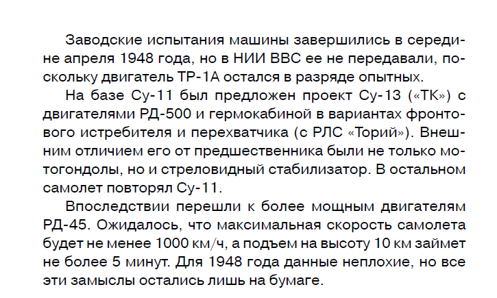

In mid-1947, a draft design of a modified Su-11 aircraft with two Dervent-V engines (a domestic analogue of the RD-500) was developed, which received the designation Su-13 in correspondence. However, due to the lack of stocks of production facilities at plant No. 134, the construction of the Su-13 practically did not begin.

The Su-13 is a frontline fighter, a modification of the Su-11 aircraft. It was
supposed to replace the TR-1 engines with more powerful RD-500, use a
wing with a relative thickness reduced from 11 to 9%, and a swept
horizontal tail.

- Su-11 (Aircraft LK) was a single seat jet fighter,developed from Su-9,
but powered by two TR-1 engines,1947
- Su-11 (Second prototype) was the same as above,but with U-5 boosters
and braking barachute,1947
- Su-11 Mod. was the same as preceded,but with a modified engine nacelles,
may 1947
- Su-13 (Aircraft KD) was an improved version of Su 9/11,but with pressurized
cabin,increased wing area with a thinner profile,project 1947
- Su-13 (Aircraft TK) was the same as previous,but fitted with Thorium
radar and two 37mm cannons,1948
- Su-13 (Aircraft MA) was a single seat jet interceptor aircraft project,no
other details
- Su-13 (Aircraft M) was also a single seat jet interceptor aircraft project,
with no details

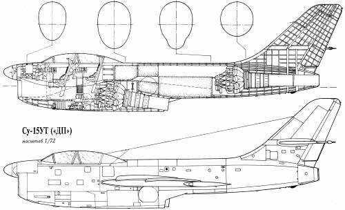

Also Su-15,
- Su-15 was a single seat all-metal jet interceptor aircraft,with swept
wing,powered by two RD-45 turbojet engines,1947
- Su-15T was a two-seat trainer project version,with N-37 cannon,and
powered by two RD-45 turbojet engines,1948
- Su-15 was an escort fighter project version,with increased capacity
of weapon,powered by two RD-45 turbojet engines,1948
- Su-15 was also an escort fighter project version,but powered by one
TR-3 turbojet engine,1948
