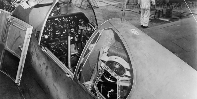

Just put up a new article at RetroMechanix.com on perhaps the earliest USAAF P-51 modified for the photo reconnaissance role:
It features 11 large photos of the camera installations, along with a summary of the memorandum describing the modifications. Check it out if you are a fan of rare Mustangs!
-Jared

41-37327 was first and only installation modified at NAA and designated P-51-1-NA

If this was directed at me, let me elaborate. 327 was modified at Army request at NAA Inglewood - all other P-51-NAs so modified, were Depot modified and designated P-51-2-NA and later designated F-6
