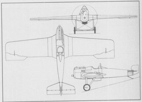

It seems to be the Junkers J 2 (military designation E II)
Some pics here :
http://www.google.fr/images?hl=fr&source=imghp&q=Junkers+J+2&btnG=Recherche+d%27images&gbv=2&aq=f&aqi=&aql=&oq=&gs_rfai=
A 3-view from Green/Swanborough "Jagdflugzeuge der Welt" (Fighters Of The World):

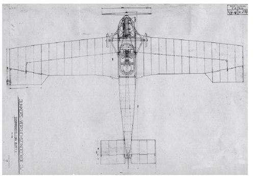

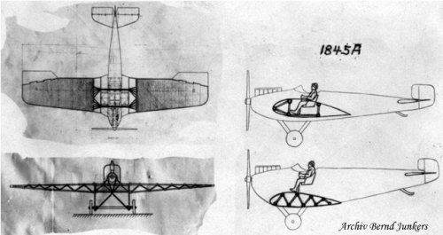

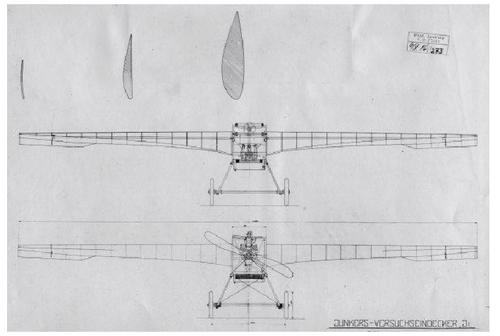

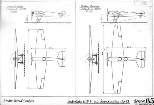

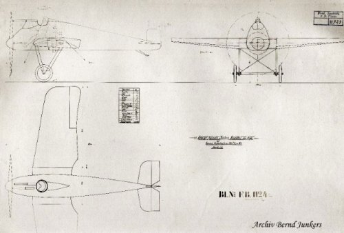

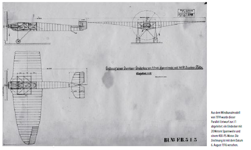

http://translate.google.com/translate?sl=de&tl=en&js=n&prev=_t&hl=ar&ie=UTF-8&eotf=1&u=http%3A%2F%2Fwww.ju-f13.de%2Findex.html

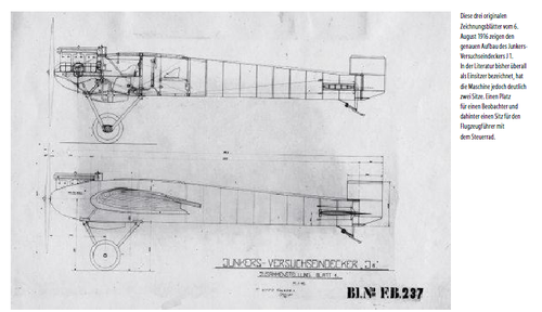

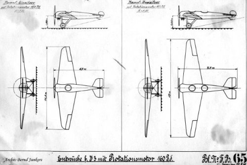

From, Flieger Revue Extra 83.
