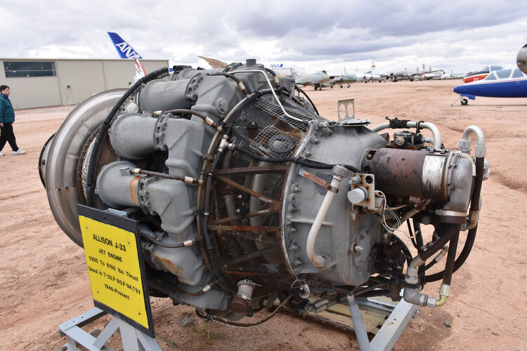

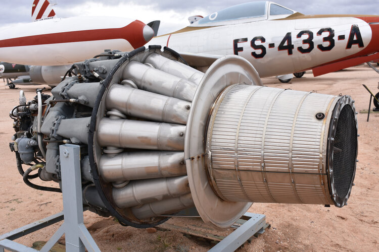

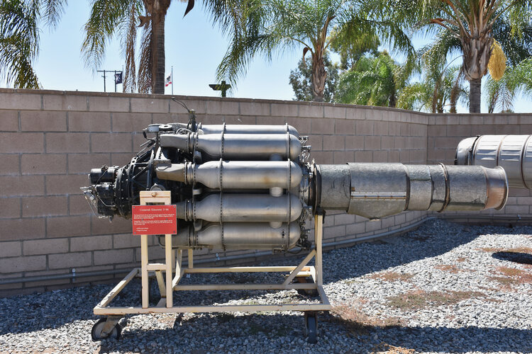

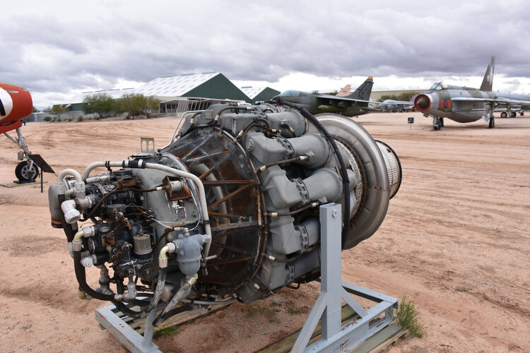

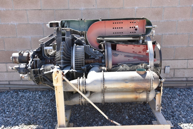

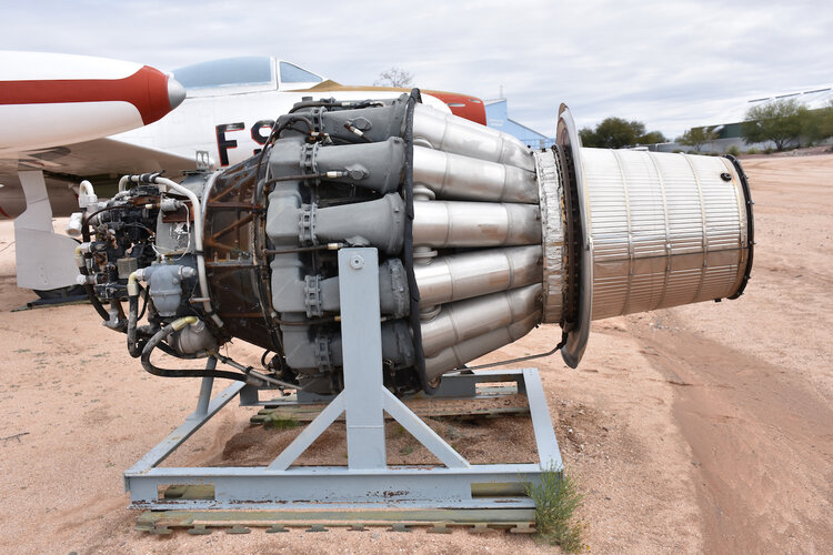

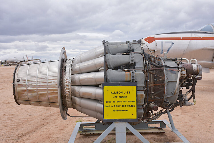

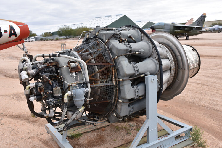

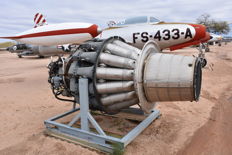

Early Allison J-33 with centrifugal compressor and burner cans.
