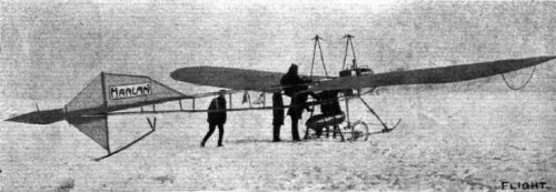

the Harlan Type 1911 and Type 1912 military monoplanes are a little known
Germany aircraft.
http://flyingmachines.ru/Site2/Crafts/Craft28524.htm
http://flyingmachines.ru/Site2/Crafts/Craft28717.htm
The first photograph is the Harlan monoplane built in 1910-1911 in a lot of variants. Two-seater with open wooden fuselage and 50 hp Argus. In this type of plane records were set by Karl Grulich (1911) and Siegfried Hoffmann (1912).
The second photograph is the Harlan monoplane on which Ernst Krüger won the Rund um Berlin contest 1912. Two-seater with enclosed wooden fuselage and 100 hp Argus.
