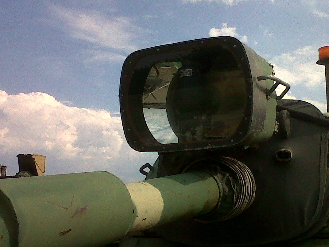

Any "active IT illuminator" really is a searchlight, only operating in different wavelengths.
It can be used from a helo, MBT or anything else, with the drawback of all projectors: if someone has the right filter, you're a bright beacon.
Significant drawback, but still better than being blind.
