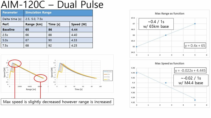

I found this blog (http://jaesan-aero.blogspot.com/2018/10/?m=1) that ran tons of simulations for various design parameters/configurations including dual-pulse.
The range improvement with dual pulse seems quite small (+4.6%) and trades off speed and time to target (extra 7% TtT)
Dual pulse extends the "cruise/coast" phase of flight so you are essentially trading time for range and also improving end game kinematics if you time your second pulse to provide that terminal increase in speed. If you don't want or are being driven by time to target, then you obviously don't get much use out of it.

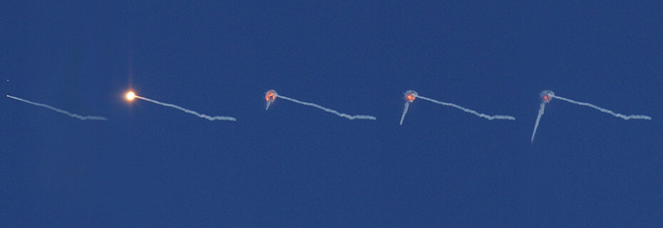

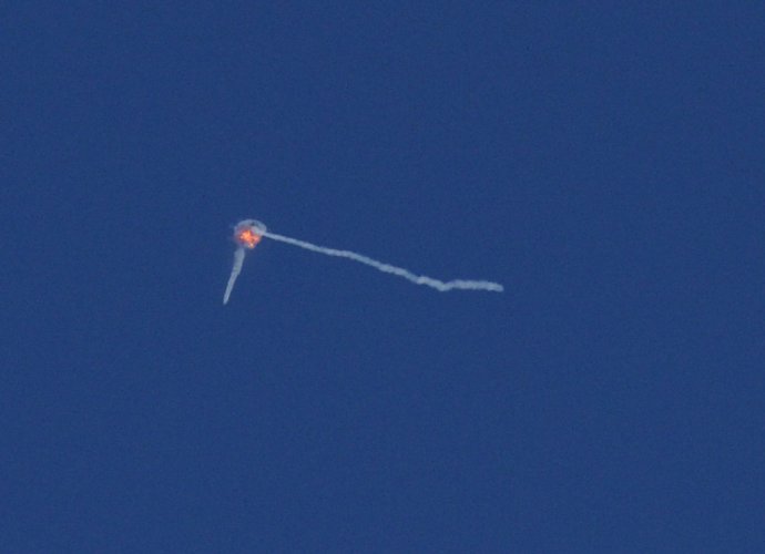

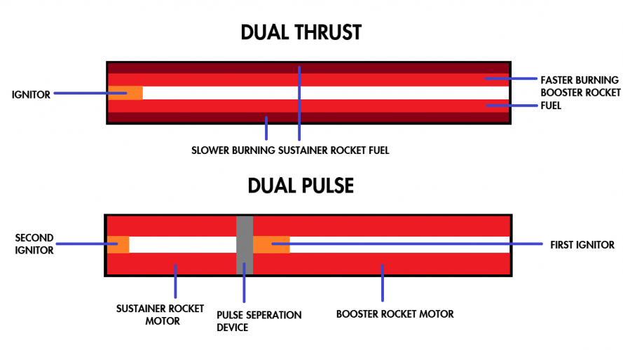

What is a "dual thrust" motor? Single grain with a boost/sustain burn profile? Let's be very clear what a "dual pulse" vs "dual thrust" motor is. A "dual pulse" has two seperate motor burns, seconds or longer, apart. Not sure what a "dual thrust" motor is. I suspect probably a mistake in translation. A good example of a dual-pulse motor is the PAC-3 MSE. Below shows the second pulse starting (horizontal trail, no it isn't the divert thrusters firing) shortly before impact.

Yes, dual thrust motors have two types od propellants, typically boost and sustain.

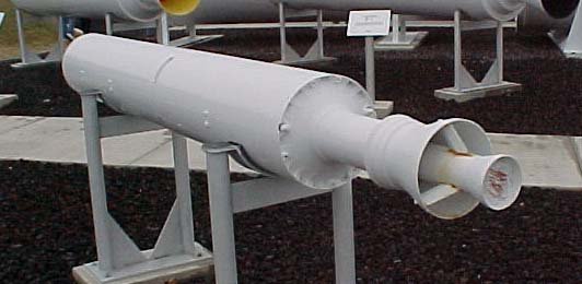

This! An example of a dual-thrust rocket-motor is the Standard missile's Mk-104 sustainer motor.
"Dual thrust" seems to be synonymous with boost/sustain. Some use a tailored grain profile, some use discrete grains, burning sequentially, with no time gap in between.
Boost/sustain rocket motors seem pretty standard for medium/long range missiles. I think the term "dual-thrust" might be a bit obsolete due to the confusion it causes with dual-pulse rocket motors.
Also in dual-thrust SRMs the boost-grain often uses a faster burning propellant loading than the sustain-grain.
