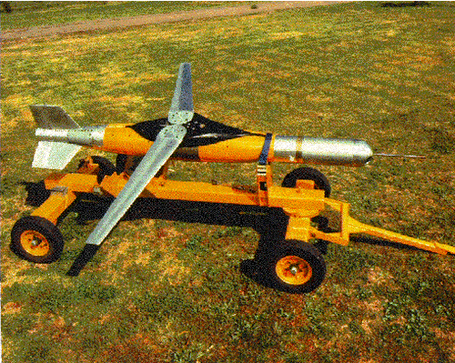

I remember it being discussed in the late 1980s in the open press but it seemed to disappear and was never adopted by the RAAF. Carlo Kopp once mentioned it in passing to me in an email but that was the last I heard about it.
A google search reveals this article which strangely enough is by Carlo Kopp. It does include a picture.
Unfortunately any Google searching gets you swamped with either Kopp's article or the recent Ferra news (which has nothing to do with Kerkanya in reality).
Kopp's article is pretty thorough. It was written in the 90s when he was working for Australian Aviation magazine and is based on a brief by the contractors working with DSTO. It predates the JSF and the Su-35M so one isn't going to be lead astray...

The image from the article that hark40 found. A very belated thanks to all of you!
