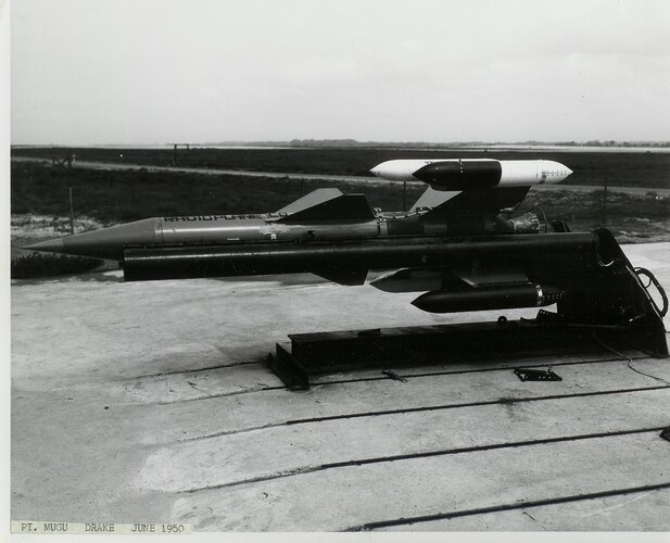

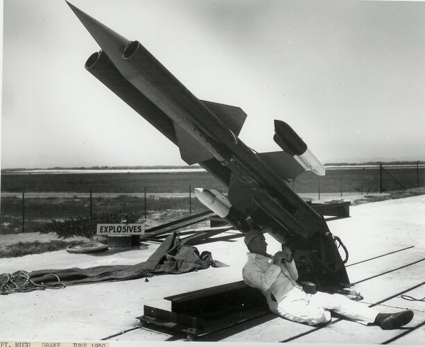

A government history of the Pacific Missile Test Range had this photo in it. It is captioned as a "Drake" circa 1949. I can't find anything on it. Anyone got anything?

Hm. It looks like a modified version of Private test vechicle, with different fins and added JATO bottle.

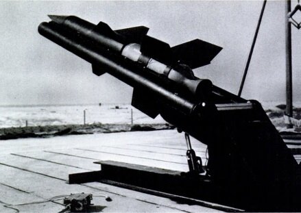

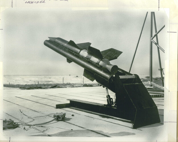

I suspect, and at this point, only have a suspicion, that it is some variant of one of the Navy's CTV, LTV, or RTV programs. That is, it is a Control, Launch, or Rocket Test Vehicle. There are numerous variations of this sort of rocket, and most are not well documented. They were relatively cheap, expendable designs used to develop various systems for what because operational missiles.
A CTV missile at Topsail Is. N. Carolina part of Project Bumblebee
Early CTV
I've seen photos of some others that look similar to the Drake, but nothing specifically called Drake.
No clue on that nor the wingtip pod things.
I suspect they may be radar reflectors, to increase the missile signature for easier tracking. Or visual tracking aids: each seems to have individual pattern of black and white parts:

* Upper right - black forward, white rear
* Upper left - all white
* Lower right - all black
* Lower left - white forward, black rear
I suppose this pattern allowed for visual tracking of how missile roll.
My guess is that given that the launcher is so close to the ocean that they are empty and used as floats to allow recovery of the booster section for re-use to keep launching costs down. The way the back end of them looks, they might also contain a parachute to assist in keeping the booster intact on release.
Hm, there is definitedly some cable going on from the rear part of each pod along the fin into missile. And the rear part of the pod looks like clamshell hatch bolted together.

(viewing from the same point as camera):
Likely. I think this rocket / missile is two-stage too with the booster separation just behind the forward set of fins. I also like they're using copious quantities of duct tape... ;)
