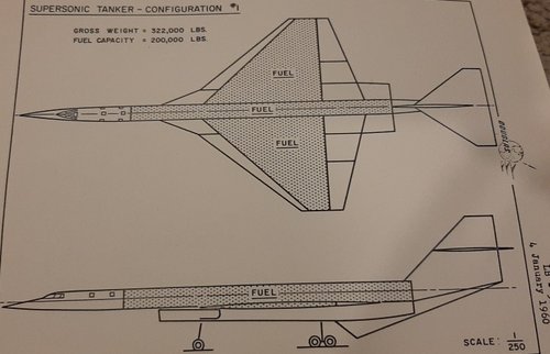

This might be relevant.
  • Supersonic In-Flight Refuelling.pdf
I knew this but, that's a very clean document here. The original is horrible so thanks for sharing !
What that a private sale pitch or did the company answered a RFP or WS something ?
