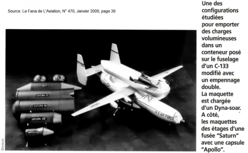

From Le Fana de l'Aviation latest issue (#470, January 2009) page 28-39. C-133 article from René J. Francillon (highly recommended)
1. Oversize Cargo Lifter (twin tailed) with a set of different containers. There is a model shown on page 39 with a Dyna-Soar. The labels in the other containers are Apollo, Saturn SIV, Saturn SII, Saturn SI and RIFT.
I did overlook this one.

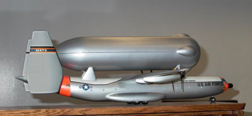

The C-133 Saturn Carrier model survives to this day.

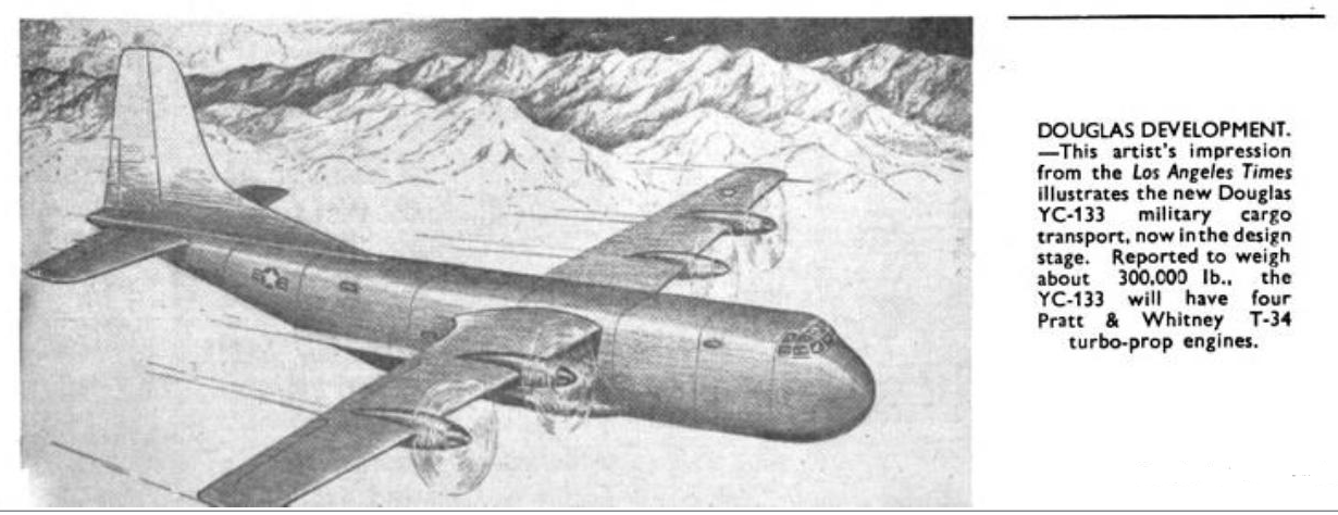

Wasn't the C-133 a b*stard to fly ? I can't see its flying characteristics improving with a giganormous Saturn stage on its back.
From Aeroplane magazine 1954.
