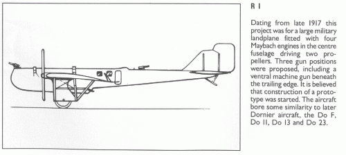

Browsing through long neglected books or mags sometimes brings some results:
In Bob Ogden's "Dornier Reference Library", a special issue of the Fly Past magazine,
I've found a four-engined bomber project from 1917 and still yet no mention in other
posts here:

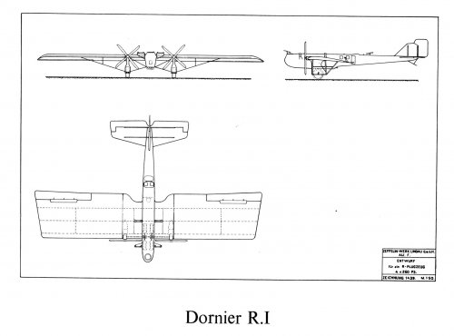

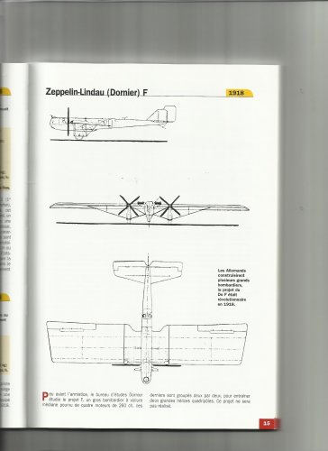

Hi Jens
From the Minidocavia "Les avions Dornier"
Many thanks ! And this one is a complete 9-view!
Seems to be a case of a double use of a designation, as I only knew the
forerunner of the Do 23 as "Do F". Am I right, that following this source the
construction of Do F/Do R.I wasn't even begun ?
Yes Jens, in my book it's write for the "do"F" of 1932
First use of this letter for a projet dated 1918
Bye
