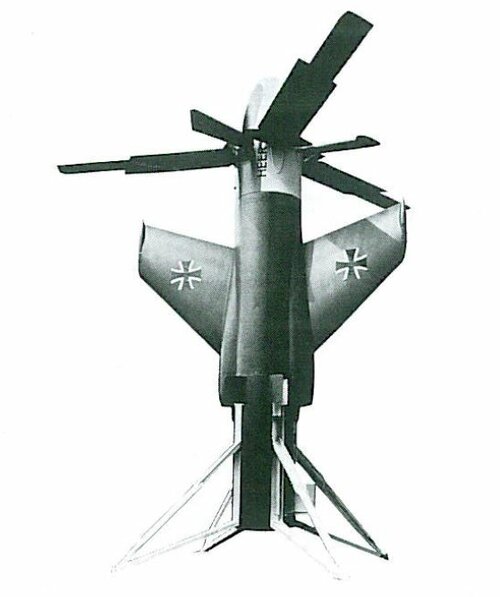

However i can find very little information on it. There is only one article (from 1971) that describes it in some detail. The article has a unlabeled picture that fits the desciption of the KAD. I translated the relevant part of the article using DeepL and also attached the original.

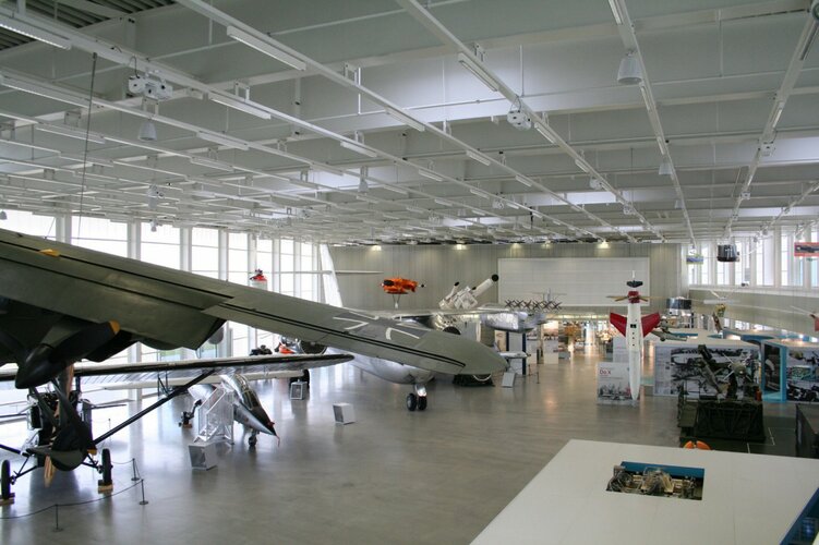

The article mentions that the drone is on display in the Dornier Museum but i cant find it on any pictures of the museum exhibits.
Also this is the only source for the designation Do33. In the Dornier Post its always just called KAD.

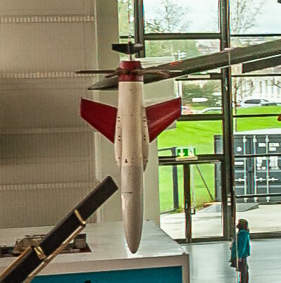

Found it!
Relatively small in the background of a larger image, but its still very recognizable.
Im not sure if the displayed drone is in its horizontal or vertical flight state, the rotors look somewhat shorter than in the image in the first post, but it looks like you can see the fold-out nozzles between the 3 rotors. That would mean its in the hover/vertical flight mode:
To achieve accurate landing near the ground station, the drone was to land vertically with a rotor like a helicopter. For this purpose, three shortenable rotor blades on the rotatable tail section served as a tail unit in a stationary longitudinal position during cruise flight; for rotor flight during landing, they were rotated, extended telescopically and were propelled by the hot exhaust gases of the jet engine through 3 fold-out nozzles. The drone thus technically formed a drone-helicopter combination.
The bottom/front looks significantly different from the image in my first post, i would guess this is because that image had the sensor section already detached as described in the wikipedia entry:
In helicopter flight, the drone was to first deposit the sensor section at the battery's evaluation unit and then relocate to the repair and launch preparation unit to be prepared for the next mission.

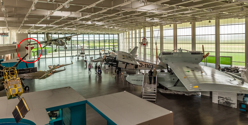

Found it!
Found some more photos from different angles.
Its hard to judge the size but it seems to be roughly similar to the CL-289 on the ground.

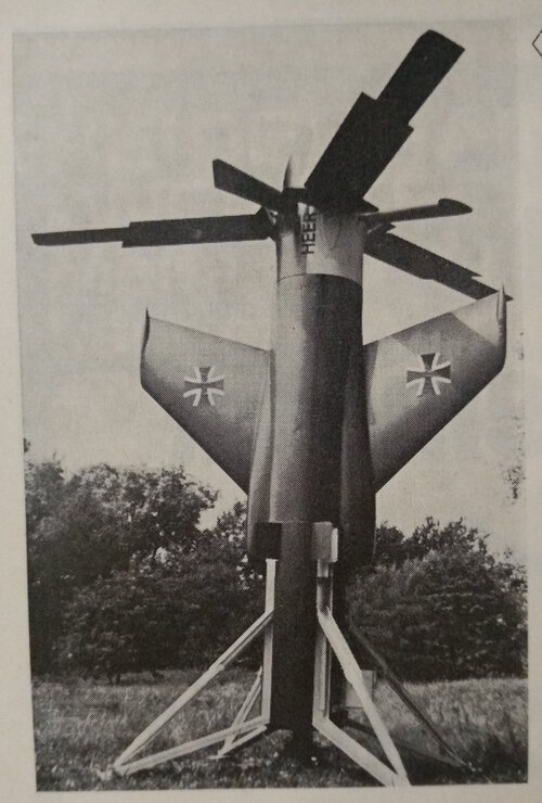

Found a somewhat higher quality version of this picture in a Wehrtechnik issue from 1971 here
The description confirms my guess that the image shows the drone with already detached sensor section.
Also according to the description the development had at this point already been cancelled after 70 million of 290 million DM budget had been spent.
