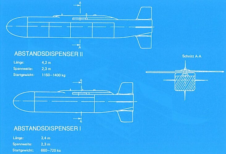

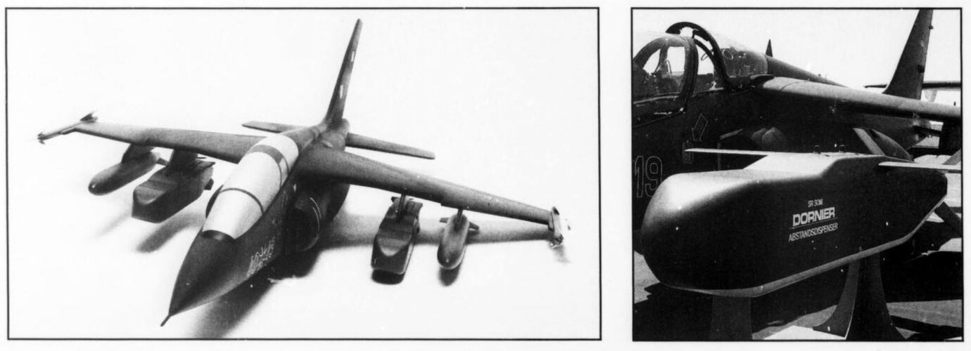

The vertical weapon system was a podded anti-tank weapon which fired projectiles downward as the carrier aircraft overflew the target, proposed for the Tornado IDS as well. Basically, a modern take on the Schräge Musik principle, applied to air to ground missions - I think the rectangular dispensers on your image actually show the system. The obvious flaw in the concept was the requirement of direct overflight over the target, of course - a suicidal proposition against contemporary tactical airdefences. Predictably, somebody realised the force of this argument eventually and the concept was binned.
Somebody correct me if I'm wrong, I don't have access to the FlugRevue issue where I recall reading about it...

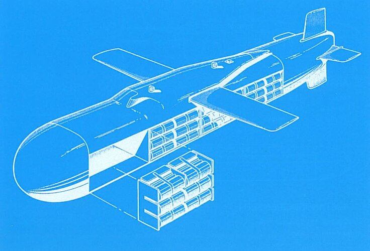

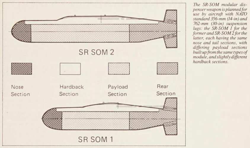

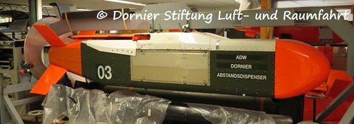

I think it's rather MSOW/SR-SOM/MoBiDiC - a more conventional cluster weapon, glide-type dispenser - than VEBAL. I remember some pictures of this "vertical weapon" (called VEBAL, VBW or Syndrom) - the early dispensers were more streamlined, with round or elliptical cross-section, the late model were rectangular but more flat than these on photo, and have many holes on upper surface for gas exhaust (the projectiles were rocket-propelled grenades). I try to find these pictures and write something about VBW later.

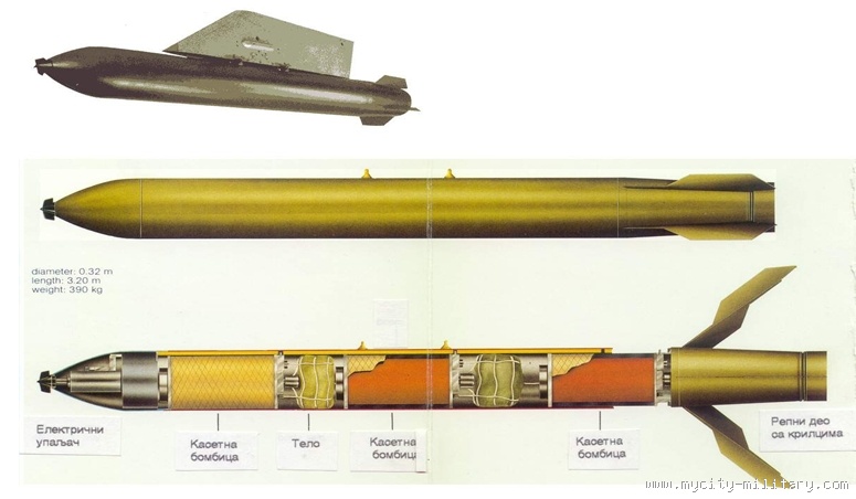

Sounds a little like a German equivalent to Thomson Brandt’s BM400 / CASCAD? (Close Air Support Cargo Dispenser)
This was a 390kg glide/rocket boosted dispenser with 3x 90kg modules for fragmentation charges/submunitions, 5-10km standoff range in toss bombing attack)
