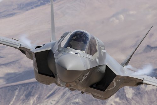

Are any of the apertures below the cockpit for gun aiming?
As far as we publicly know it does not; the pilot can dial in a burst size (so that a trigger pull only fires something like 5 or 15 or 30 rounds), but the aiming is manual. The only real assistance would be the FBW's ability to hold the aircraft's attitude / stabilise the aircraft, meaning that recoil and turbulence is countered.
