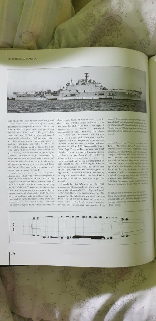

I will check in the book:
British Aircraft Carriers: Design, Development & Service Histories by David Hobbs
if it contains more info regarding the Audacious class development.
Thank you very much! By the way, I should buy that book if I have a chance.

If you want detail on the background to the development both the carriers and the aircraft, Friedman's British Carrier Aviation is a better purchase IMHO. I have both in the library and they are complementary, the Hobbs book having some better detail (facts & figures) on lifts, catapults and histories of the ships.
Thank you both so much for your help! If I have a chance later, I will buy the book you told me!
