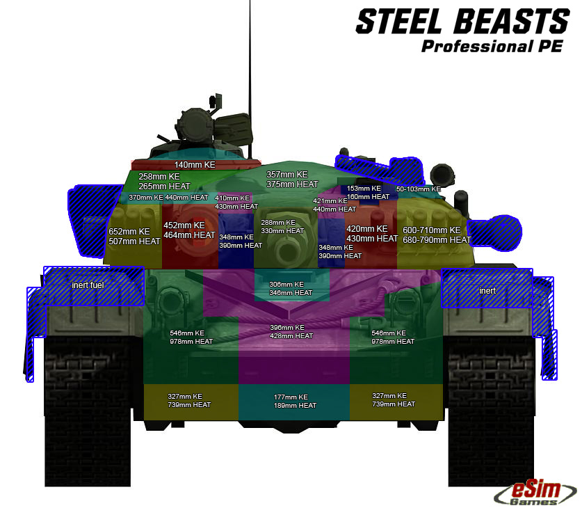

...and the T-72A was poorly protected in comparison to T-72B!
Hilmes (2009) offers frontal protection values for T-72A as 250-400 mm RHAeq KE and 250-490 mm RHAeq CE for T-72A.
He also offers 520 mm RHAeq KE and 950 mm RHAeq CE for the T-72B turret front.
1980's 105mm APFSDS had typically about 330-360 mm RHAeq KE penetration.
http://collinsj.tripod.com/protect.htm
The very latest APFSDS of Germany was capable of defeating only 520mm RHAeq KE protection in 1991. The two earlier generations of German 120mm APFSDS were incapable of the same.
The British were in 1991 introducing a 120mm APFSDS that had only about 530 mm RHAeq KE penetration. Their older 120mm APFSDS was apparently incapable of penetrating a 1990 state-of-the-art T-72 turret front.
The U.S. M829 - much hyped up since Clancy's jingoistic book - was barely able to offer a bit more than 520 mm RHAeq (~550), which could easily translate into an inability to penetrate the latest T-72 turret front armour as well, since the DU's advantage is in slicing through steel with tip forward while the T-72's protection was so strong because of an entirely different mechanism (the attempt to break the long rod with lateral force in order to distribute its kinetic energy on a larger base armour area).
Both the U.S. and the WP emphasized hull-down fighting a lot, so turret armour is much more relevant than hull armour. Tanks which expose their hull would very often move in zig-zag to make hits less likely and thus expose their thin side armour anyway.
Finally 75 of the East German T-72's underwent a modernization in the late 80's and likely featured better protection than the T-72A by the time of the re-unification while none of the Iraqi tanks were up to 1980's T-72 standards despite all of them were delivered in the 1980's.
According to what's publicly known today it's possible that by 1991 Western tank cannons were pretty much defeated by the newest Soviet turret front armour.
Guess why we introduced new APFSDS versions and even some L/55 barrels despite the lack of threat evolution!
according to what's publicly known today it's possible that by 1991 Western tank cannons were pretty much defeated by the newest Soviet turret front armour.

Interesting webpage here which partially confirms the results.
Very interesting diagram:
Admittedly, supplied by a game designer but Steel Beasts is a cut above most games and considered a simulator (and sold as such to military users) and very well researched.
As can be seen, frontally the tank is extremely well protected.

So if I sum up; the gist, you have one Jane's article and a drawing from a video game? I try and keep an open mind, you might be 100% correct but I think a detailed annotated summary of sources would be helpful for me to assess the facts as you present them.
