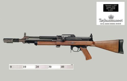

A quick look at the DISA museum webpage shows two interesting weapons:
http://www.thm-online.dk/genstande/54-b1186-1159/
Apparantly the first weapon was designed for Finland in 1957 (7.62x39mm) but lost out to the AK-47 leading to redesign in 1959 as a 7.62x51mm rifle.

From the first picture the weapon on the left is a gas piston operated weapon of very similar design to the AK-47 or AR-18 with the charging handle affixed to the bolt carrier. Judging by the vents on the gas piston tube it is probably a short-stroke gas piston weapon and likely an AR-18 clone upsized to 7.62x51mm.
The two weapons on the right look like the same design just scaled to the different ammunition. It appears to be a copy of the Mauser StG-45(M) with roller-delayed blowback operation. Just a bit more refined than the WWII German original and taylored for the more powerful 7.62x51mm in the centre weapon.
