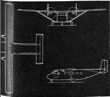

Just a better 3-view from Janes 1964-65

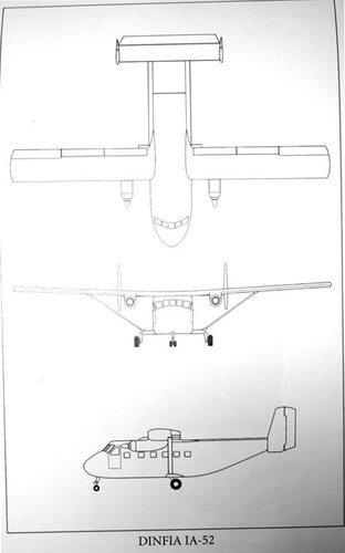

here is anther drawing to I.A.52 with more details.

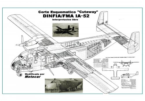

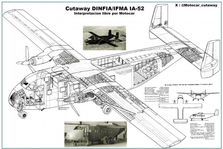

Cutaway DINFIA I.A.-52
