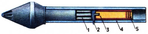

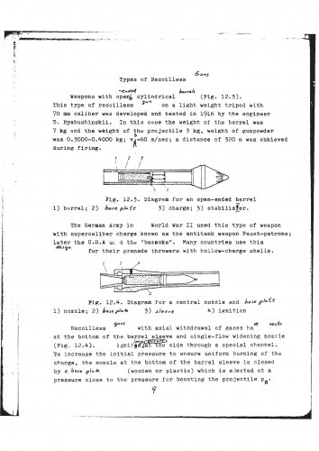

While researching Leonid Kurchevski's series of RCL's I came across a reference to the above here: -
http://www.dtic.mil/dtic/tr/fulltext/u2/a023513.pdf
See page 30, top RH column. Googling the name brings up a lot of biographical details (he was big name in fluid dynamics) but nothing else. However, I found a US patent in his name for a 'Rocket gun'.
https://www.google.com/patents/US1661091?pg=PA3&dq=rocket+gun&hl=en&sa=X&ei=nA2zUb-bNMPJ0AWa4YGABg&ved=0CDgQ6AEwAA#v=onepage&q=rocket%20gun&f=false
An illustration on the Russian side of the Internet also suggests a rocket, that isn't an over calibre warhead by the way. Does anyone have anything to input on this?

Thanks for that. To me it seems very similar in principle the Panzerfaust.
