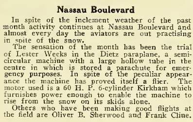

On August, 1911 Dietz Paraplane and Biplane together were parked at Nassau Boulevard aerodrome at Long Island (Aircraft, August 1911, p. 204).
The paraplane was tested at the same aerodrome on December, 1911 (Aircraft, January 1912, p. 377):
You may see, the aircraft had "emergency safe landing system" - parachute in the fuselage tube.
Also, both Shiver-Dietz and Dietz Paraplane used Kirkham engines.

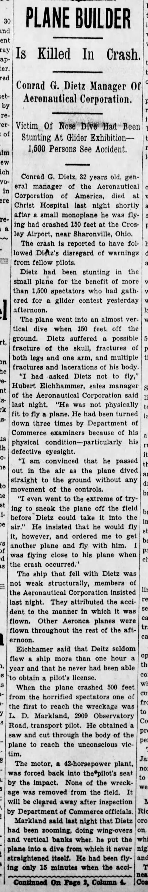

And the main point. Conrad G. Dietz, the first general manager of "Aeronca", has died 13 September, 1931, at the age 32. In 1911 he was twelve years old.
So, I am quite sure that Paraplane was created not by C.G. Dietz, but H.J. Dietz

I've found direct proof that Paraplane was built by Howard J. Dietz:
"Howard Dietz, of Mill Road, Hempstead, L.I., has a monoplane over which is fitted a hollow mast containing a parachute."
Aeronautics, July 1911, p. 18
Dietz's Paraplane was alive at April 1912 and was stored at the same Nassau Boulevard aerodrome (Aircraft, May 1912, p. 89).
