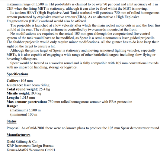

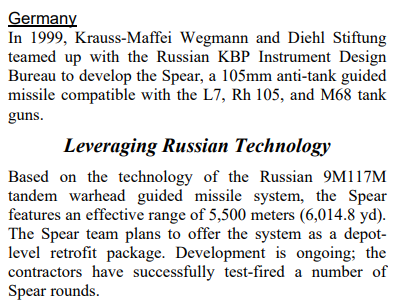

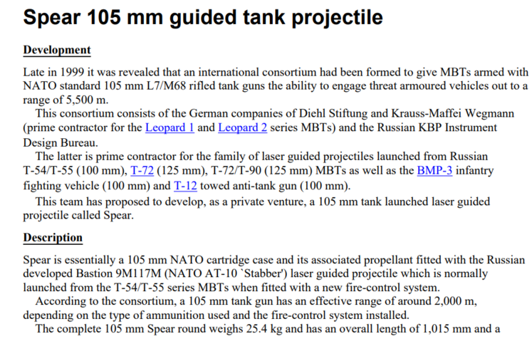

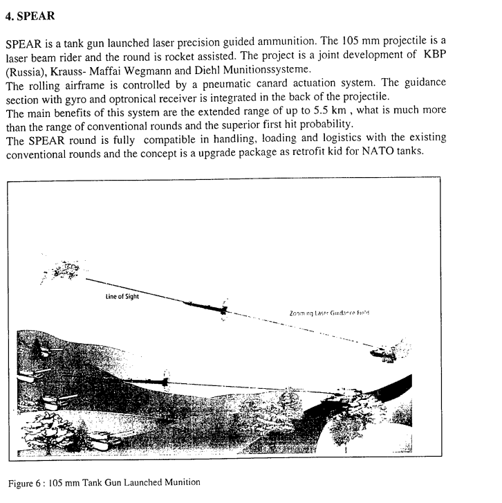

Does anyone have any more information about the gun launched beam-riding 105mm projectile?
Here's what i have:
  • https://www.forecastinternational.com/archive/disp_pdf.cfm?DACH_RECNO=843
    Screenshot 2024-09-17 002152
  • https://apps.dtic.mil/sti/pdfs/ADA385710.pdf
    Screenshot 2024-09-17 002216
